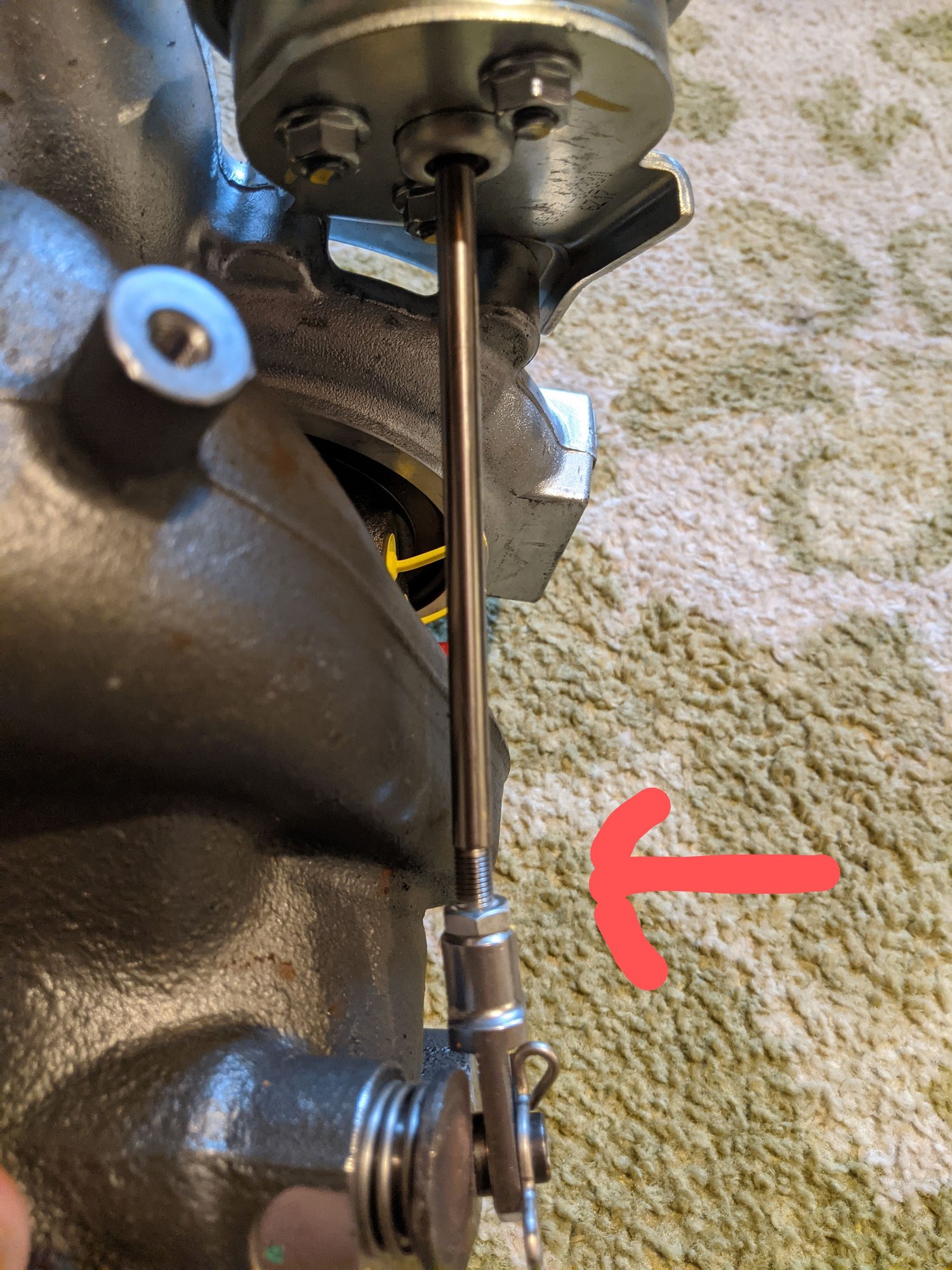

I got a new old stock turbo and I see a slight bend in the wastegate actuator rod. Is this something I should be concerned about or just send it? Pic attached.

If it still has room to function without hitting something and it looks like it does then it's not an issue. I've seen those types of rods bent in all kinds of shapes to clear things in different applications like shift rods and carb linkages and so on.
