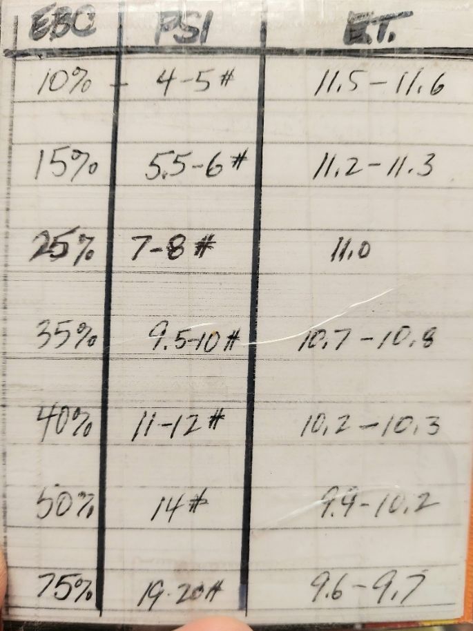

I totally understand wanting some control. My controller has just two boost setting presets. I use the main one (default), as my "low" boost, and the 2nd one as my "high" boost, or in my case, triggered with an external "scramble" button, since I bracket race.
I datalog every pass and made myself a little laminated "cheat sheet", which tells me (pretty closely) what % to set my controller at, for a specific amount of boost, and ET (footbraking). I can pretty closely dial in anywhere from mid 11's to mid 9's, and anywhere in between, and may try some 10.0 Index class racing this year, so I 100% get what you want to do.
So, to run a 10.0 index, using transbrake, I'd need 40% duty cycle on the mac valve, or 50% if footbraking, since car is obviously slower (or mine is anyway). Then tweak it a few % one way or the other to get dead on.
