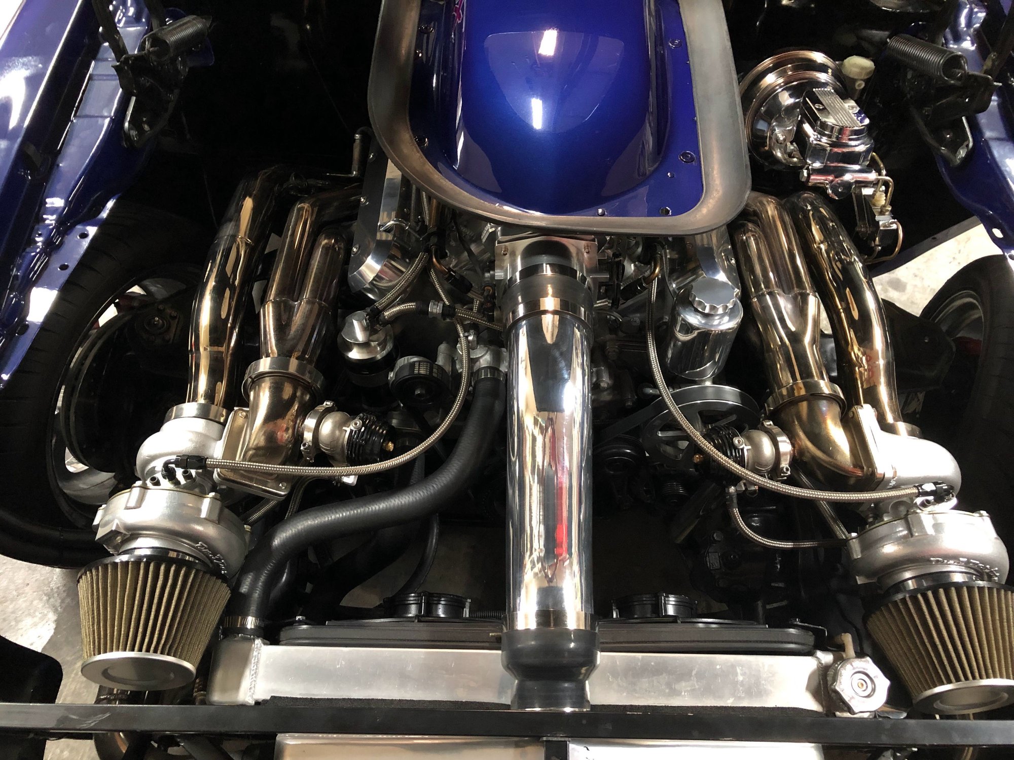

I don't know how helpful this will be as I haven't tried to dyno my car with the filters off, but i'm running a pair of R2C CO10541b filters on my BW S362's on a 6.0. Numbers in sig, so I think they flow pretty decent and aren't huge with an overall length of 6.25".

I’m in that range, but have two filters, which cuts the flow in half of course. I’m also wondering about your fuel statements, I use 80lb and 450lph pump without issue. Might be something else going on.
