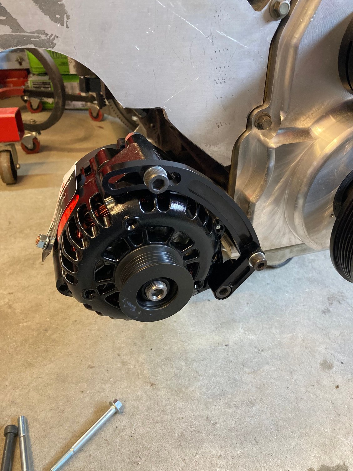

I wanted to know if anyone has ran a passenger lower alternator mount setup on a flipped forward shorty truck header setup? I think the room might be there but I'm not sure and was wondering if someone else had an example. I pulled all the exhaust off and tapped the block on driverside to mount it but piping is in the way. Wasted a couple hours for no reason!! The passenger side looks to have more room.
The kits tht look to be the best fit are AEIcnc or MotionRaceWorks. Hoping someone has something tht works. Thanks.

There are a few but they aren't cheap... or that nice IMO. I run one.
https://www.motionraceworks.com/prod...bracket-10-150
https://www.lssimple.net/purchase-co...ee-shipping-us

This is the MotionRaceworks mount. As you can see, it’s quite tight to the block. I don’t have an exhaust manifold to hold up to it for you though.

I purchased the ict upper alternator bracket kit for electric water pumps. My 105amp ls alternator almost fits. A smaller case alternator might work. I found one from scramspeed I think I'mma give a try. They say it's a smaller case and 130amps.
I would have liked to use the ls1 lower driver mount setup with a stretch belt. Just don't have room unless I redid the turbo piping. Thanks for the input guys

Hey what alternator is tht u running? Can u get a side pic? I purchased the ict billet upper passenger brackets. My stock alternator is to big and barely touching headers and outer body panel. Tht alternator u are running looks smaller than oem. Thanks.

PowerMaster PWM-58247
It’s an AD230 style.
https://proshop.summitracing.com/parts/pwm-58247
