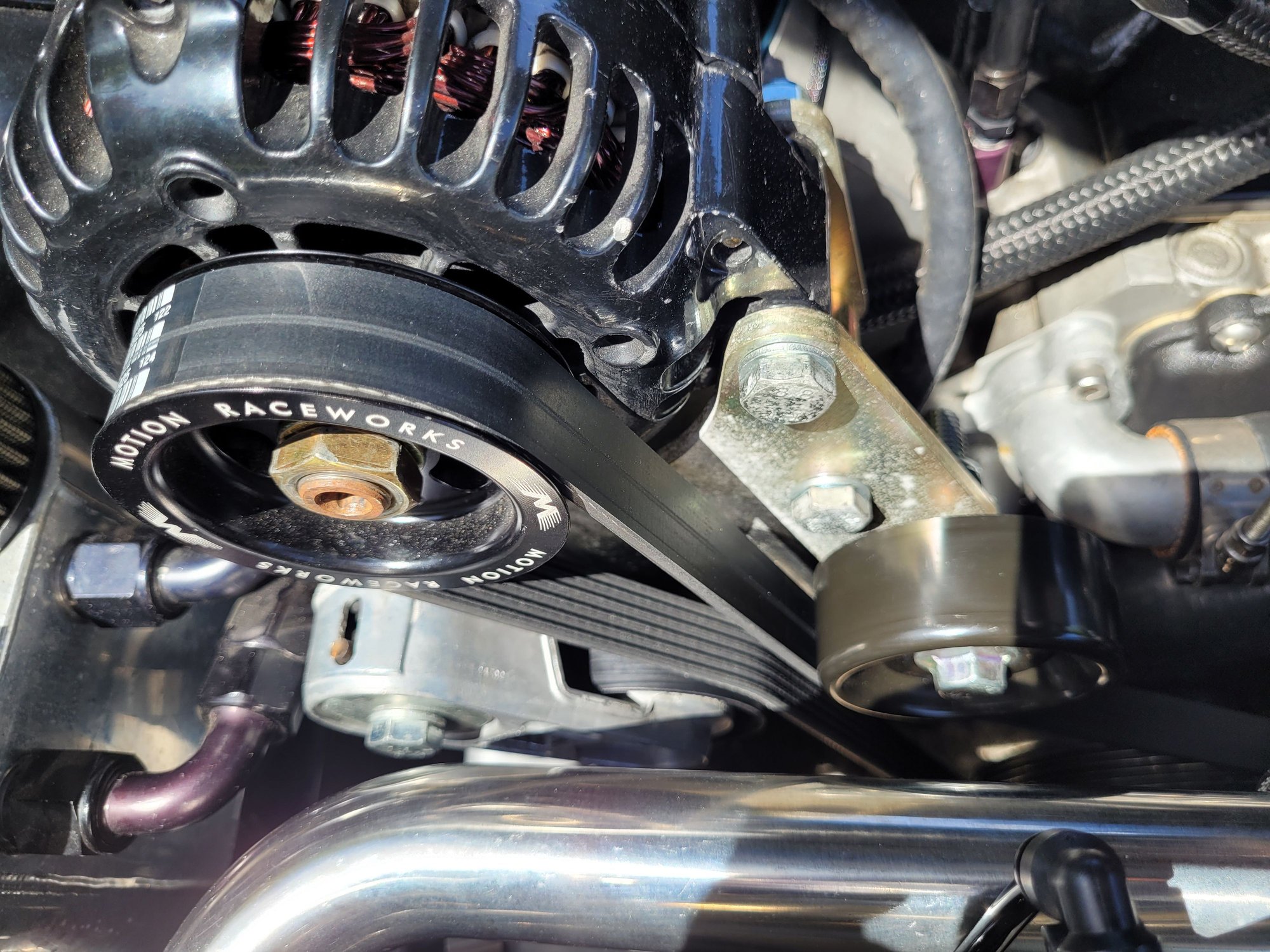

Alternator to water pump belt top side looks like a long, unsupported run (bracket holds the alternator out pretty far it seems). Could flap and twist with a lot of harmonics in that length. Could you put an idler in there to just give it a bump out of being a straight shot?
Also, a 175 amp alternator rotor will have a lot of mass, which acts on the belt at a shift. Can you try a de-coupler type pulley? They were developed for fast shifting transmissions to keep belts from squeaking on WOT shifts.

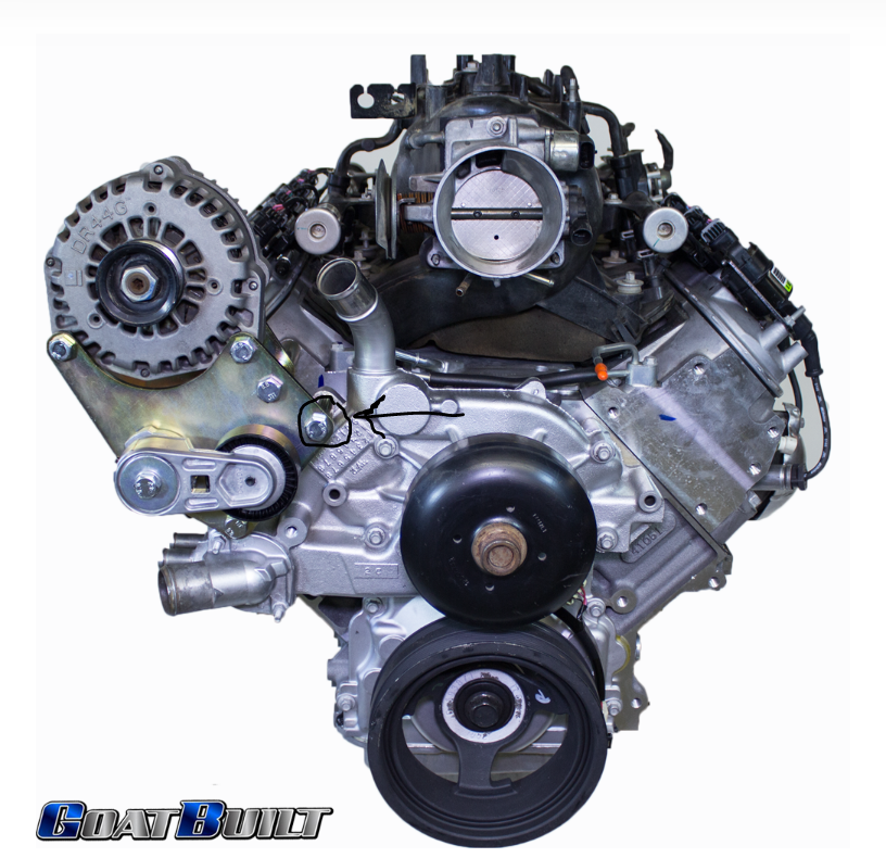

That was my thought as well because usually there's a water pump pulley there to shorten it up right?
I'm adding an idler pulley to the spot circled below since that hole is not in use and almost at the halfway point.
The tensioner pulley will make contact with it without a belt on but with a belt it will have plenty of room so I'm not too worried about it.
It will also take some slack out of the belt which should help, I'll check the alignment once the tools show up next week.
The De-Coupler Pulley looks very cool, a bit pricey but if the idler doesn't help and the alignment is good then this is something I'll have to explore further.
Do you know off hand if they make one for LS alternators?

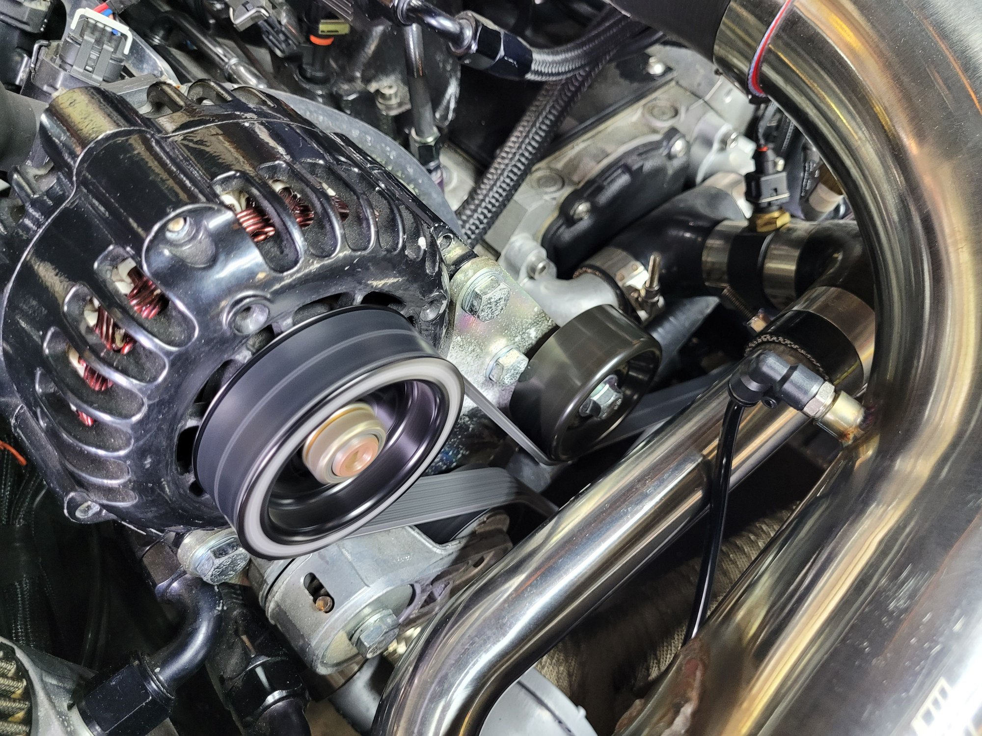

Well gents the pulley and the alignment kit showed up today.
The Dayco kit is a nice piece btw, sturdy and easy to use.
Slapped it on the crank pulley and alternator pulley and wouldn't you know it, the alignment is dead nuts on.
So its gotta be the long distance between the alt and crank, I added the idler, checked the alignment on the idler for good measure, the tensioner is almost completely maxed out but I can get the belt off and on.

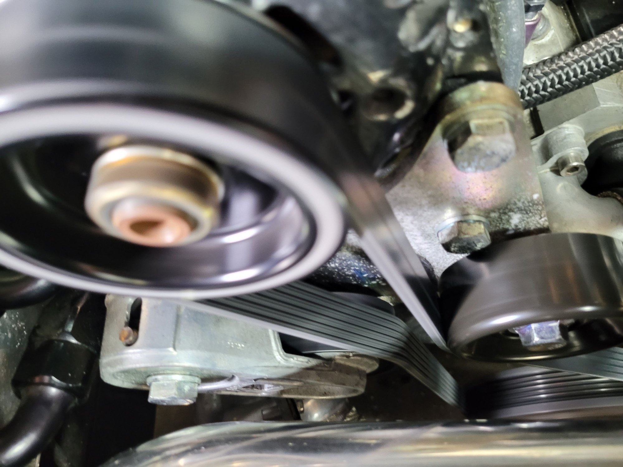

Then I saw the tensioner pulley and for some reason the belt is off just a hair, no idea why, there's no play in the arm or the pulley.
Shoot me in the face.
What do you guys think?
New idler installed
Tensioner is weird?

tensioner not in alignment, or arm is loose. belt stretch and touch other side of belt. put camera in there to watch

I can see from your picture in post #24 that the belt is not centered on tensioner and actually running off the edge. Pulley is either off centerline, or tilted causing the belt to "walk downhill" off the front of the pulley. Belts can usually handle up to 1/3° misalignment fore/aft.
You always want to reserve a certain percentage of tensioner travel in order to avoid bottoming during speed transients. I can't remember the number off top of my head but I think it's in the neighborhood of 25% travel (keep that much in reserve). This is adjusted by belt length.
You also have a rimless tensioner because it's riding the back side of the belt. I'd think that would be a total bitch for throwing belts because that's where most the slack will occur in the belt drive during speed transients. Stock is ribbed and needs extra tall rim to avoid throwing belts with high power engines and quick decel. Your particular application with rimless pulley might truly require a manual tensioner to stop the belt from going too slack. Switching to a manual tensioner would rank #1 on my list if I was in your shoes.

Just need to determine whether there is an issue with the tensioner/pulley since the belt wants to walk towards the front just a little, it doesn't come off but it hangs off the edge a little which makes me nervous.
The tensioner pulley does have a little play so I'm going to investigate that this week.

The Goat Built bracket for the tensioner actually has the ability to clock the tensioner in three different locations so thinking of what @QwkTrip said about travel I re-clocked the tensioner so it wouldn't be so close to the max end of tension, this actually moved it away from the idler as well giving me more room.
The tensioner assembly felt good with no side to side play, not bound up at all, the pulley felt really stiff on the car but once I had it off it spun freely so that was a little odd.
I also added a large washer to the back of the tensioner to move it out away from the bracket in order to center the belt, did the same thing on the idler.
The belt now rides right down the middle of the tensioner and idler, when I rev the engine in park the belt no longer wanders from one side to the other.
