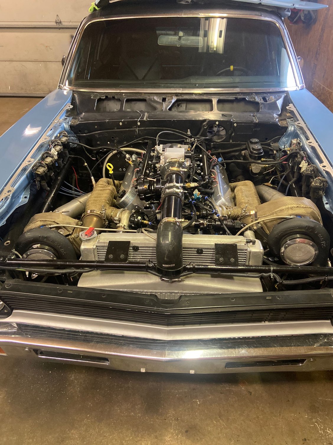

Gate placement looks pretty good to me. I see you have lines going to the dome on the gate, do you have boost reference lines going to the bottom of the gates? Make sure there is no pressure going to the domes, make sure the boost solenoid isn't backwards. The side that goes to the dome should be vented through the center port without any duty cycle.
If you want less boost put smaller springs in and see what it does. I always go with the lightest spring available and add dome psi to go up. I use on board air with dual solenoids tho. I've seen some really efficient setups where the spring # ratings just won't match up, but not usually off more than 2-3 psi

Congrats on the pass! What turbos are those? I think the gate placement should be more than adequate to control boost. It's certainly better than my plan on my twins.

Yeah for sure try a lighter spring, don't worry about what the spring is supposed to be as much as what it ends up doing. 10 different cars using the same gates with same springs will have 10 different boost levels. There's alot more variables than what they say the spring should do. From the pics the gate placement looks fine to me. I've seen alot worse work ok lol

Setups with really low back pressure will be super sensitive. The supplied springs rated at “9psi” are just a basic guideline and actual boost made will be setup dependent. As long as your boost doesn’t creep with RPM, I think your gates and location are fine. Likely just need a smaller spring if you want less boost on the gate. You'd be surprised how sensitive they are. As a test, might take your dump tubes off the gates. Bet boost drops quite a bit.
I have 5lbs springs in mine and it makes 8 and creeps to 9ish by 7500. (5.3 twin 78/75’s.) I only have 38mm gates, but I do have them on the elbow.
