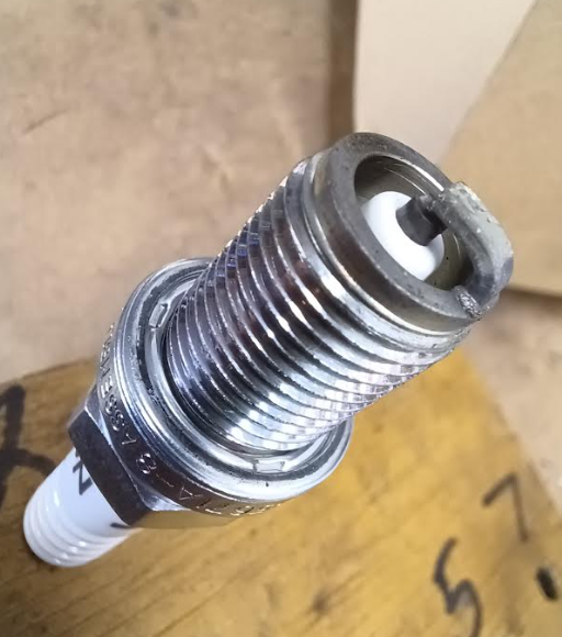

I wouldn't start out at 18* and 20lbs personally... Especially without an intercooler.
For example my twin 76mm (non-intercooled) 5.3 at 10:1 runs 14* at 15lbs. This gets me the somewhat “HOT” strap reading below. IMO you want to be about half way down the strap for a conservative "safe" tune. You can defiantly sneak up on the tune after that and get closer to the bend like in my pic if you are racing it. I add timing after 6k and I run "na timing" up to 4-5psi.
Another good point is indicated timing may not be actual timing. 18* on your setup may only be 12* on my setup. The crank/cam positioning can vary. If both parties don’t have the timing sync’d and spot on perfect with the exact same air fuel ratios in every cylinder, same charge temps, loads, weights… etc etc… Then listening to another person telling you what timing to run can cost you an engine.
If your already at 20lbs I’d pop a new plug in the leanest looking cylinder and see what 12* looks like on the plug strap.
