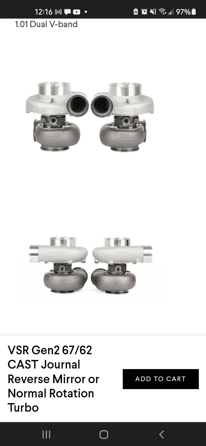

A while back I ordered a set of 67/62 vs journal bearing turbos. I am now installing them. The return is not machined for a flange to be bolted to it, it made to have a line threaded in. Can any tell me the size this port is? I contacted vs and am waiting for a reply. I figured that someone here may know. Thanks

The turbos I've messed with with threaded holes have always been npt. The feed is usually 1/4 npt and the drain 1/2 npt. You could get some pipe plugs and see which 1 screws in, it should get tight pretty quick but you'll know it's the right size.

are you sure ?
this picture looks normal

look at these pics, which are right above the Pic you linked in to description. I think these are coolant hoses, you're not confusing them are you OP?
