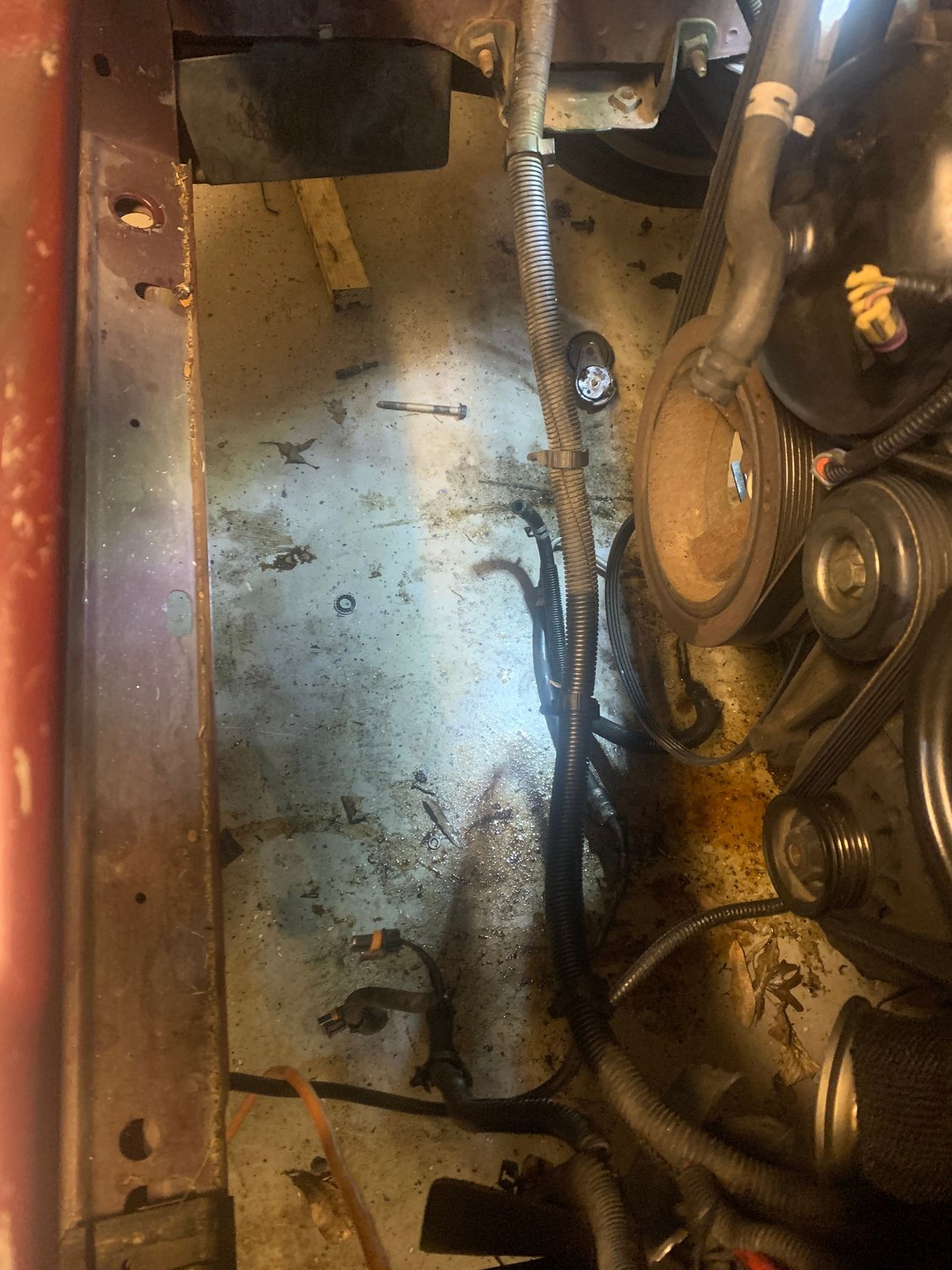

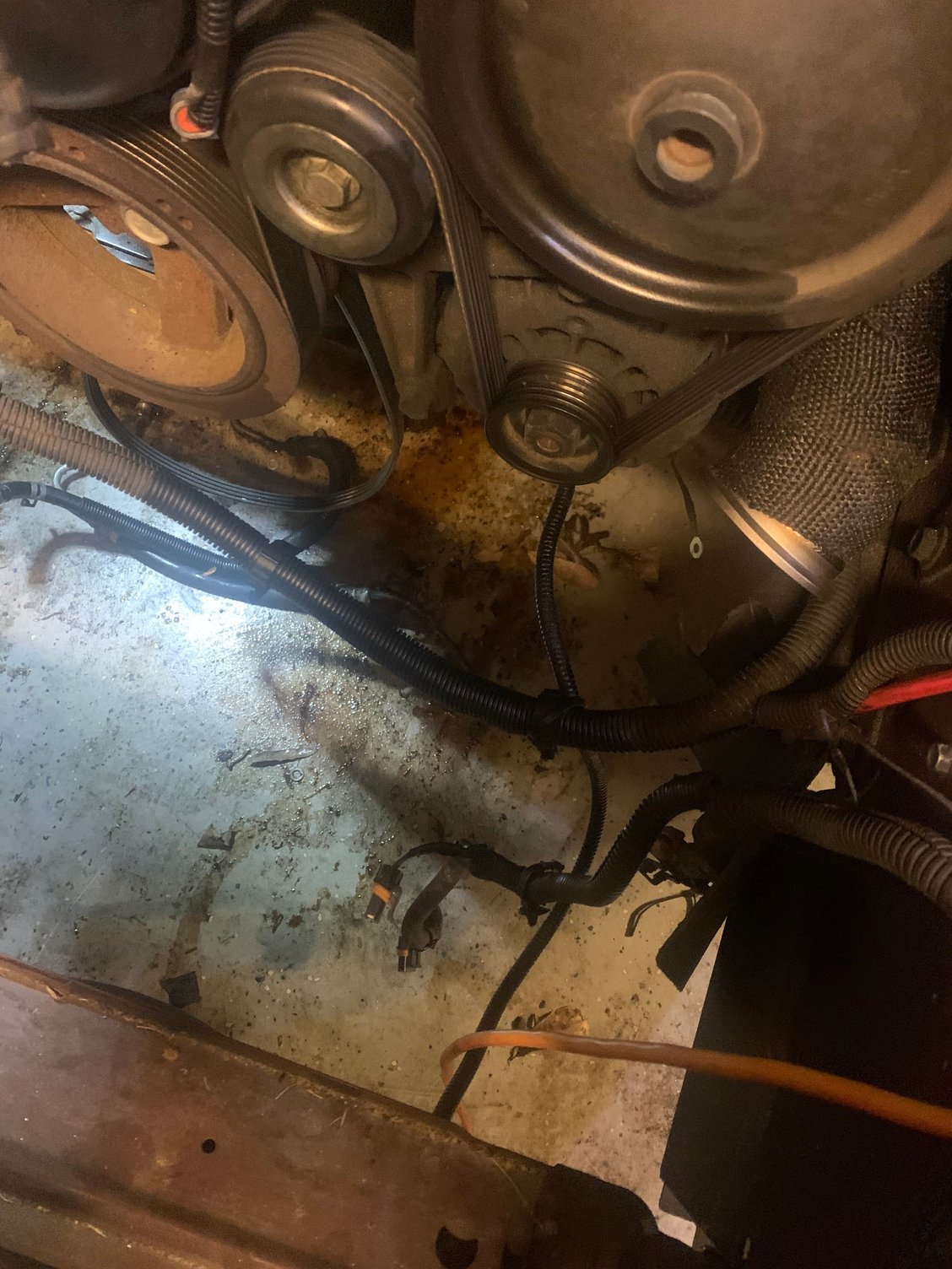

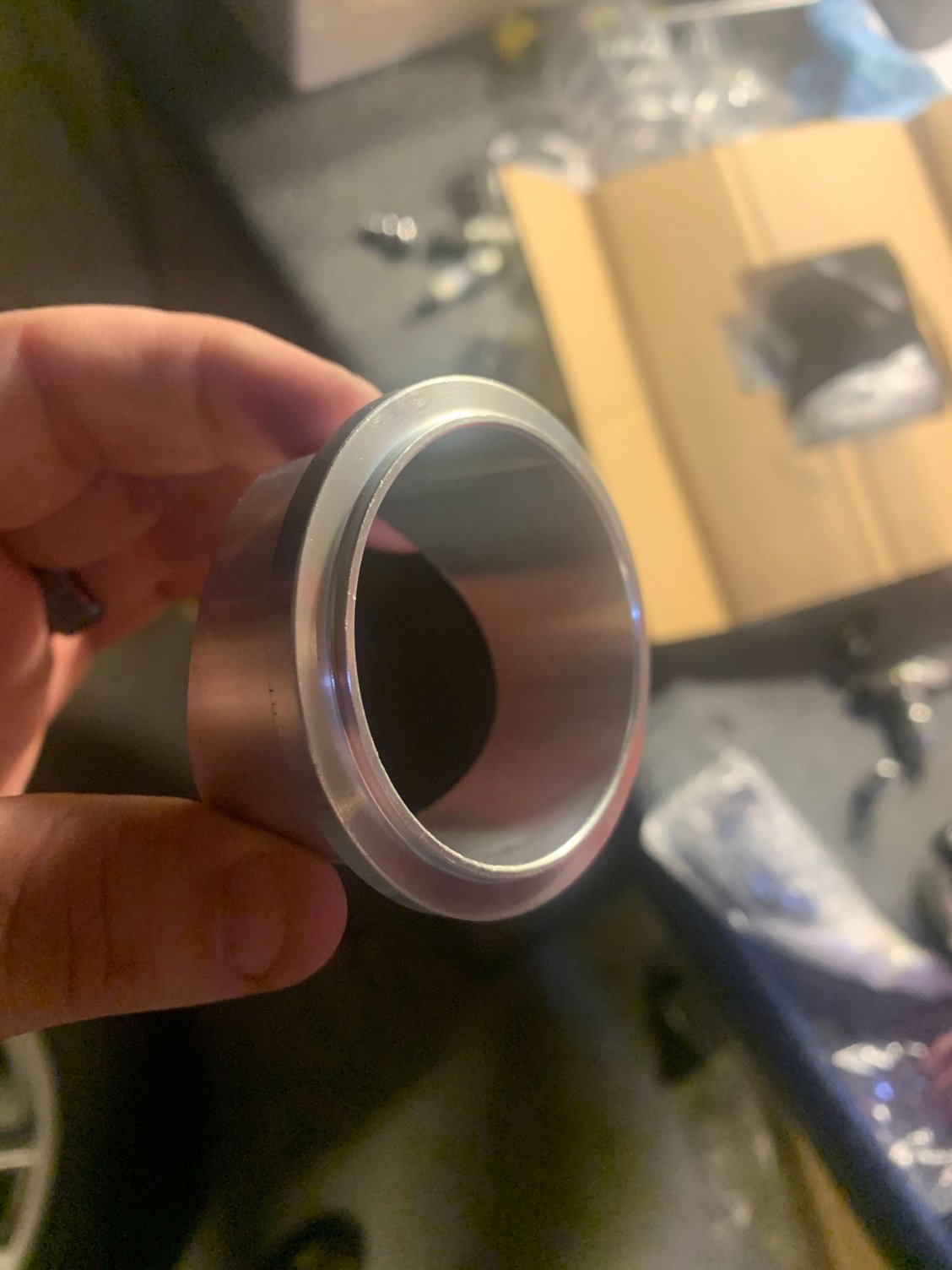

I have both Huron headers on and I am installing the cross pipe. I got to say it sits different than I thought it would. I got a couple questions. I have included pictures. How does this metal flange piece go on. Also this harness from the battery across seems like it’ll melt almost instantly. Is it enough to cover with with heat protection or does it need to be moved?

As long as you wrap the hotside and put some distance between the cable and pipe you'll be fine.
The flange in your hand looks like a weld-on flange for the BOV valve most likely as the waste gate flanges should already be welded on the hotside pipe.
Leave everything loose on the hotside, get all the piping bolted up and in place and then go through and tighten everything down, will make life much easier.
