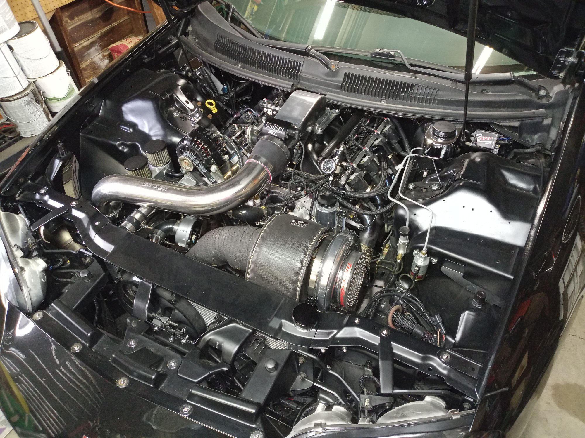

Pic of install w/ the S484.
I've been very happy with the kit and its performance, spools up nicely on the brake and has excellent clearance around components.

That's a big boy in there. Looks like it fits well though. I have a manual rack and no anti-lock brakes so that should free up a little space. Are you running power steering?

That's an older picture but I've since switched to manual brakes and the car already had manual steering.
It's not as tight as it looks either, I can still get in down around the front of the engine and what not.
