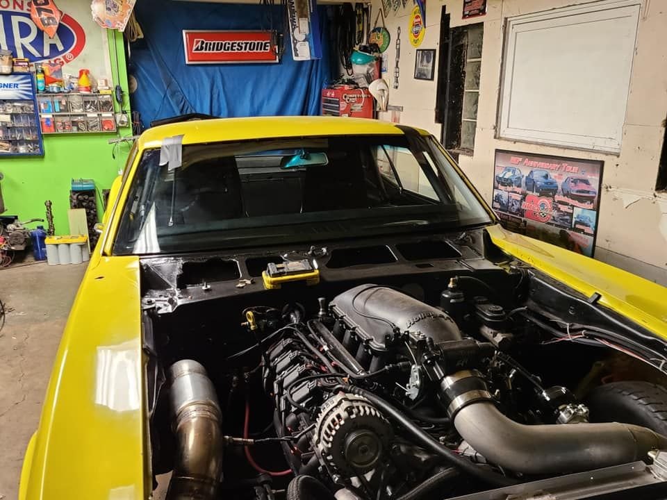

Mine is 4", I'd assume 5" would make a little more power I need to ask Capiz about that the next time we chat. But my exhaust is also pretty short, maybe 3.5 feet at the most?

My used capiz turbo had a 5/4" reducer so I went with it, he went 7.72@174 (2900 r/w) with this unit.
I later added a small 4" Burns (I think) muffler after the turbo, knocked the sound down a little.
