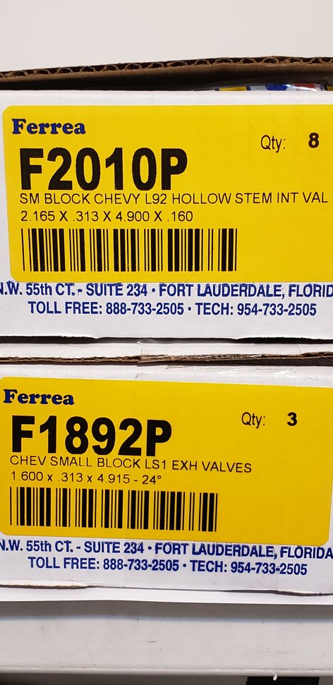

I went with these for some reason and it did take some time tracking all the exhaust valves down.
109g
98g
Ferrea hollow stem intake valves are 19-20g heavier but also have thicker walls than LS3's so I decided to go with them. Manley's are another good choice for valves and if you can afford them then go titanium intake valves.
