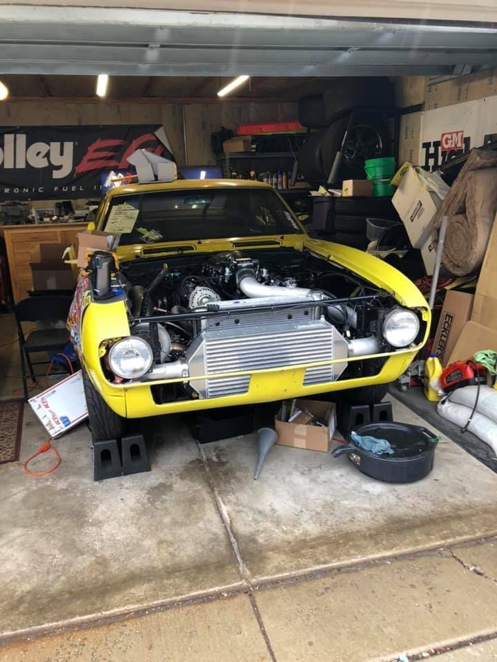

I have the Shearer 1200hp A2A. I don't any track times to share but the build quality is great. Some of the guys I rely for my car are big fans of his stuff.
My friend with the mid 8 second '69 Camaro just purchased the 1400hp version for his car, he was rocking a budget Mishimoto and it was time to make a change. He asked around and folks were pretty positive about Ron's stuff.
