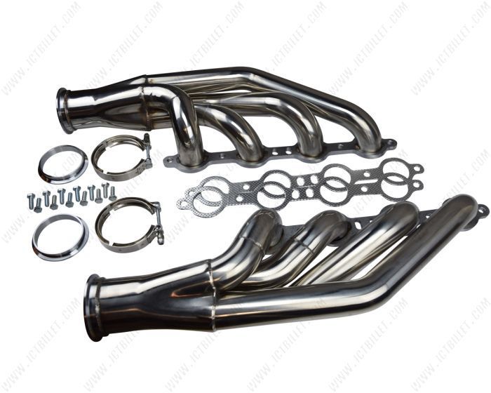

Does anyone have a measurement of how wide the Speed Engineering headers are when bolted to an LS in the down/forward configuration?
I’m hoping they will fit between the frame rails.

Are they like the standard Chinese up and forward style headers? I just swapped from a set of Chinese to a set of flowtechs and if there's any difference width wise I couldn't tell. If this is the style you speak of I can measure them in the morning, I have them mounted down and forward.

Yeh, that sounds like them. I currently have the FlowTech on my car up/forward.
thanks.
These are the SpHeaders I’m asking about.

The widest part of mine, which is the front most primaries, measure between 27-28". I also have the 1-7/8 primaries so the smaller set maybe less.

Thank you very much for taking that measurement and replying to a random guy on the internet. It appears that they will fit in my frame.
