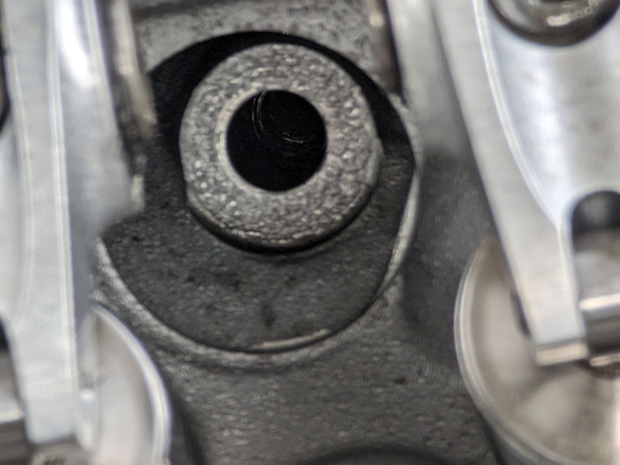

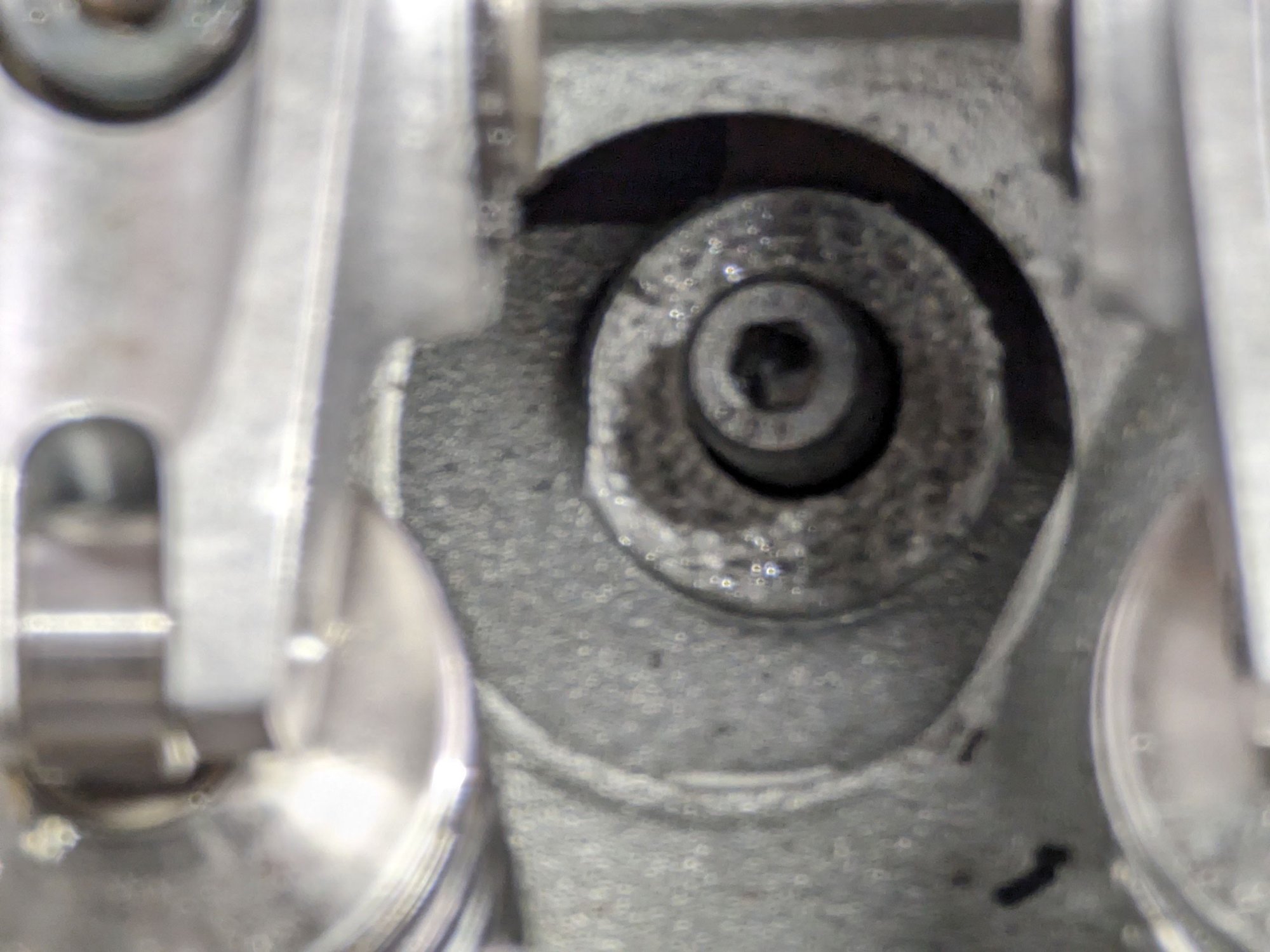

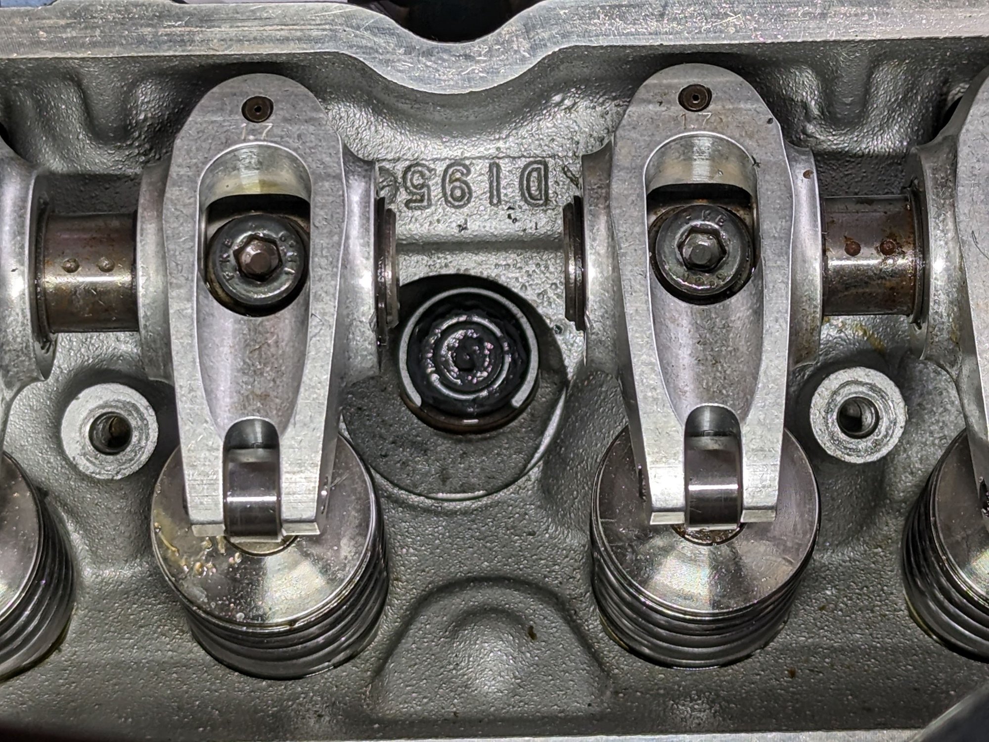

Update:
In a moment of lucidity, I decided to clean the assembly lube and coolant from the area really well, pull the single head stud and run the water pump (the head is torqued- I just removed the one stud that the leak came from).
It didn't leak after 15 minutes of running the WP (recall that it would leak with no temp in the engine; all I had to do is run the WP, it would leak).
WP at full blast, no leak
I re-installed the stud, this time with teflon paste. No leak.
Stud installed finger tight with teflon paste, no leak. WP ON.
As soon as I put as little as 25 ft/lbs of torque on the stud, it leaked like a sieve.
Cracked head at the boss, just as most of you suggested (thanks for the input). 799 castings, NOT Castec.
Wilkes Performance is building another set of heads for me, so I'll at least get it tuned and make a few passes (you can bet your lunch money I'll send it).
Thanks for the great forum and advice- it's nice to know this was one thing I didn't goof up.

Ah ha! That's all I'll say. :-)
Those cracks can be welded, but likely pretty tricky.
