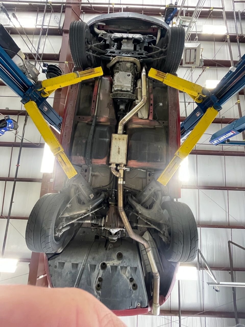

Can't seem to get a definite answer, I don't want to damage anything, so short story car was tuned open downpipe on 15lbs boost, I added full 3in to the back into dual 2.5 at the axle and lost 5lbs boost. Logic says the added back pressure made the turbo less efficient and now the waste gate dumps at lower boost, so is it okay to add duty cycle until I'm back at 15lbs of boost?

I dont really.want a cutout, i want the same power all times not opening it to gain and closing to lose, it is straight 3in to 3inle axle and then 2.5 duals no muffler so it's already free and loud, I have an oil cap breather and passenger valve cover into a catch can with drivers plugged hole.

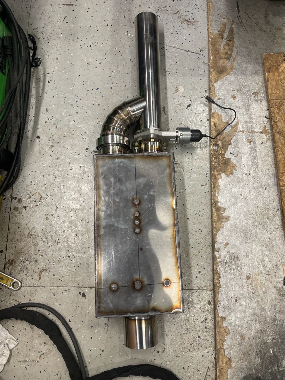

I assume your wastegate dumps to atmosphere and the cutout would be the same concept. People wire the control so that it automatically opens when the engine sees boost and then closes when it doesn't.

The cutout isn't for the exhaust system to be quiet. It's to drop the back pressure on the turbos exhaust turbine. If you wanted to add a muffler you certainly could but the cutout is just there to relieve back pressure.

when I had a single 3” on my 7875, is see 14-15psi with the cutout closed and 17-19psi with it open on a back to back run.

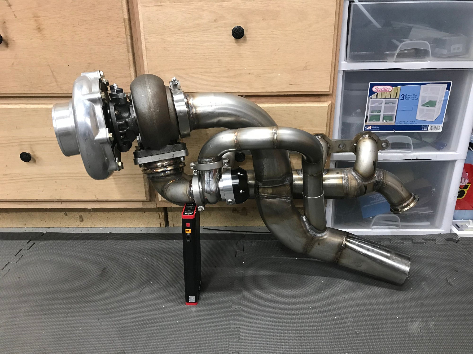

Wait, that's what you call an ideal location? The ******* wastegate is damn near 180 deg backwards from the actual exhaust flow, then makes two or three more 90 deg turns before dumping into the exhaust. And you wonder why opening the cutout makes your boost go up?
You can disagree with me all you want but I would put money on it making damn near the same power on his setup if boost is held constant whether it has full exhaust on it or not... and it's totally normal to have to increase wastegate duty cycle when you introduce an exhaust restriction, and no that doesn't mean that you have lost a bunch of power if any.

That is what i was thinking, it's 3in straight pipe into 2.5 dual at the axle so not super restricted, but def added back pressure with the run to the back of the car, back pressure equals pre turbo pressure working harder to spin the wheel so with out upping thr duty cycle it's going to open the waste gate at a lower boost pressure.

you think a single 3” is not restrictive for a turbo engine? 3” isn’t enough for a 400+ rwhp NA engine. Much less a turbo engine. Will it work? Sure. Is it robbing power? Definitely.

I did a pretty similar setup on my TA. It was a 408 into a 7675 precision turbo, 3 inch back to a GMMG catback. The turbo would make peak power at 4200 rpm and then boost fell off hard. The other thing I noticed was the turbo would howl under load. I guess give it a shot and if the turbo starts to howl and the impeller starts touching the compressor housing you'll know you have too much back pressure.
