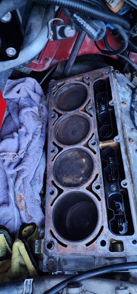

Well, I guessing time to retire the old LS1 after all these year. 1998 Trans Am with 130,000 miles on the original engine. about 10 of those years were turbo in some capacity either rear or front mount.
If anyone has seen my activities iver the past year, i recently swapped a 4l80 in, 411 pcm with 3 bar boost setting, and did swap some updated valvetrane for a Summit stage 2 turbo cam.

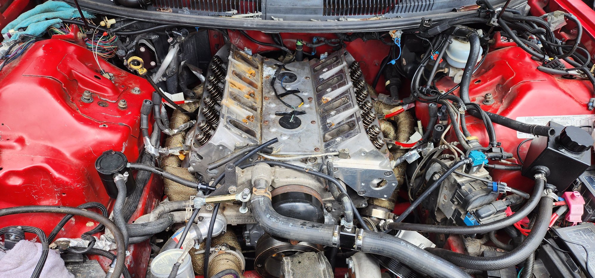

Well, i messed up and pushed water into one of the combustion chambers and after sitting a while, I busted a rod apparently. At first I thought I just had a leaking head gasket and was running fine, but after a long sit, it filled up with water and busted the rod. fortunately it was only for a second so damage was minimal but what's done I'd done.
a little water and that chamber was full!
before finding out that i had more than some head studs to torque
at least its clean
can you tell which one gave up? what caught my eye first was the kissed piston. then i went to clean the piston and i moved it by hand into the bore.... yep, thats done.

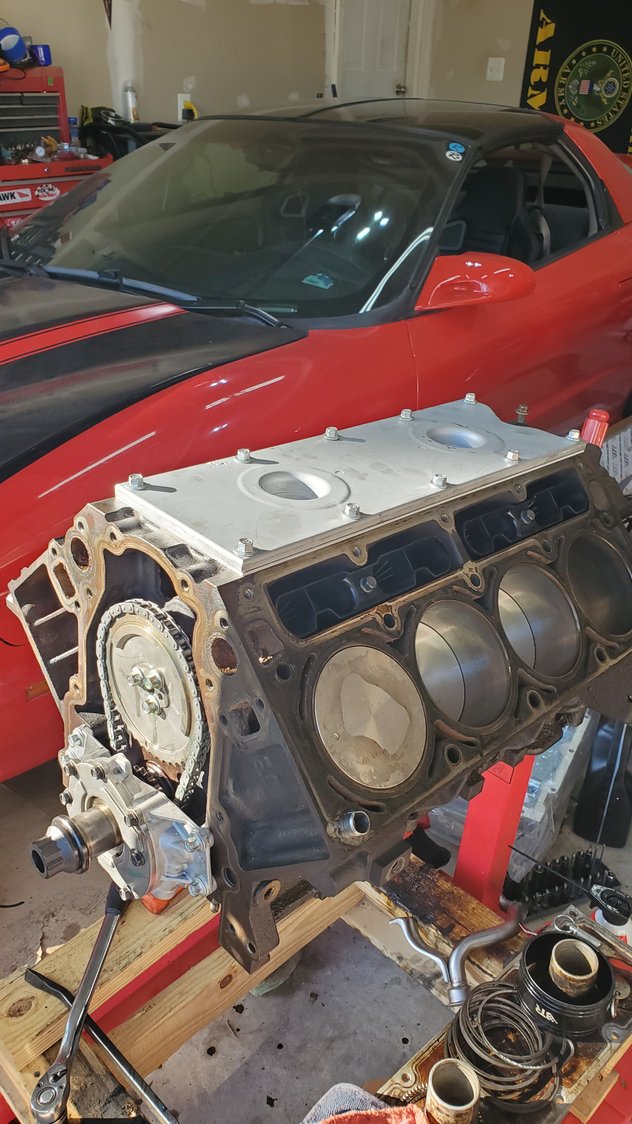

so, fortunately, I have a LQ4 I was gonna use for boost specific build anyway. well, now it's gonna actually go in it.

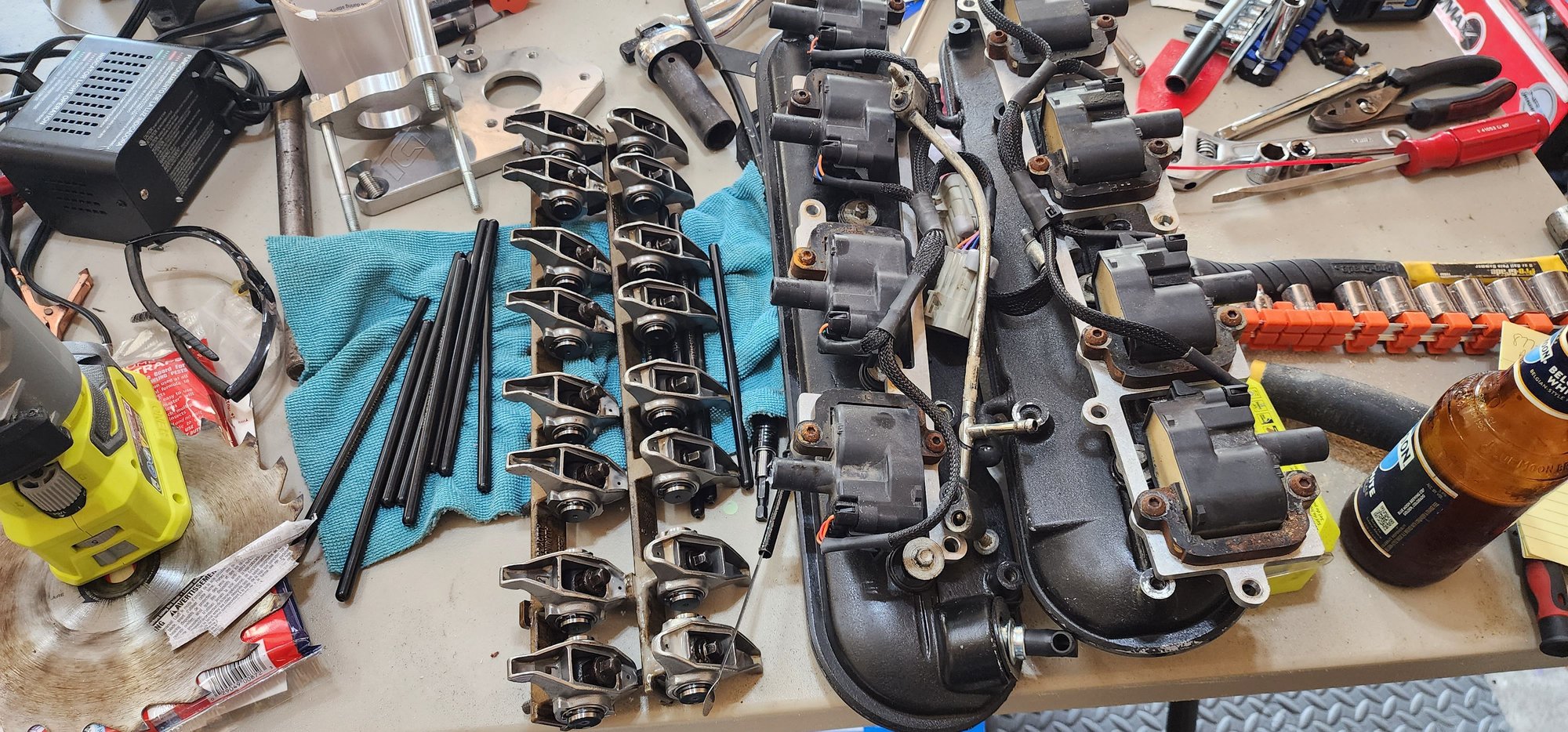

LQ4 with 4th gen rods, ls2 pistons, stock crank currently, but might consider forged rotating assembly, but I already have everything to build this engine, and just have to swap over the ls1 upgrades including the cam. the 6.0L will also get the bigger 7875 gen 2 turbo over the gt45 that is on it currently.

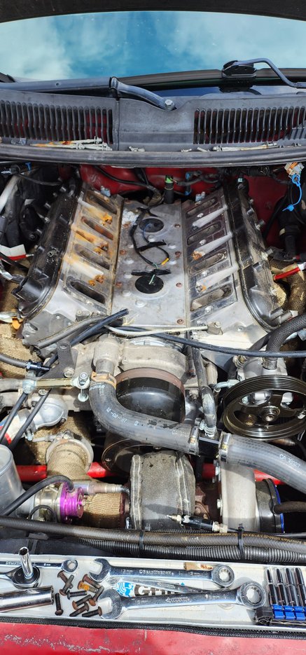

heres when i was initially just putting it together. have to put the cam back i it, as its currently in the hurt LS.

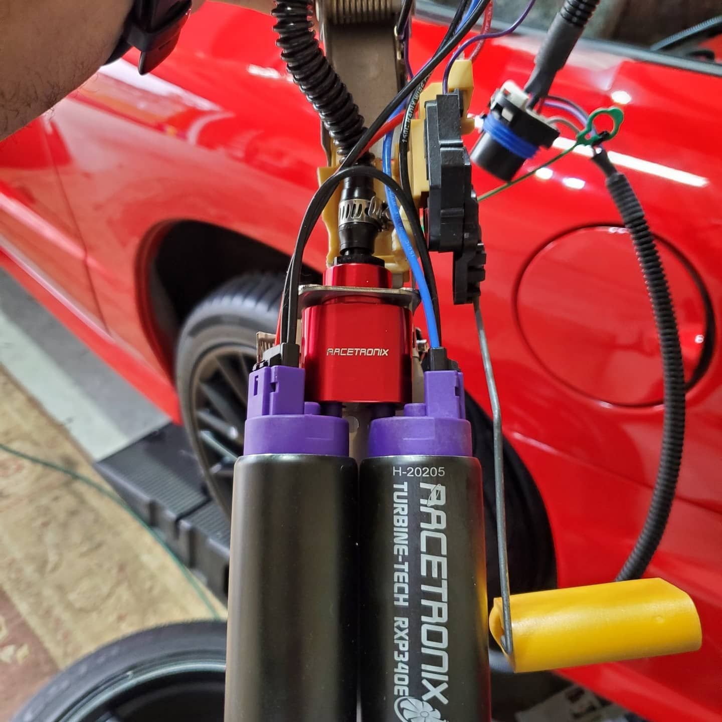

dual 340 racetronic pumps with dual hotwire kit, feeding deka 80lbs injectors, and full fuel return.
so.... yeah... engine swap time, and yet... another hptuning session. this car is starting to **** me off lol at least with the heads off, pulling the trans bolts will be easier.

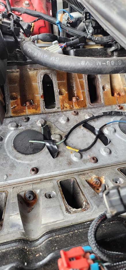

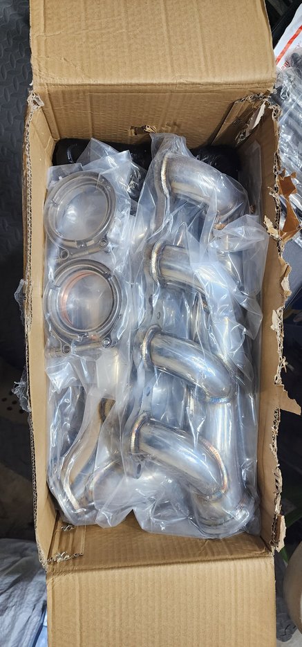

got these to replace the cxracing manifolds so i can access stuff. gonna have to fab connections to the merge.
3" collector with Vband. much cleaner primary. as much as i like the equal length on the cxracing manifoldss, they just get in the way of everthing.

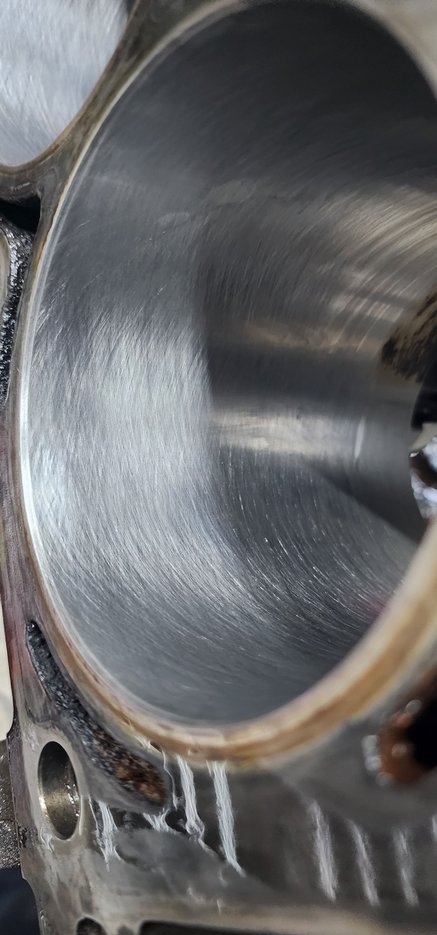

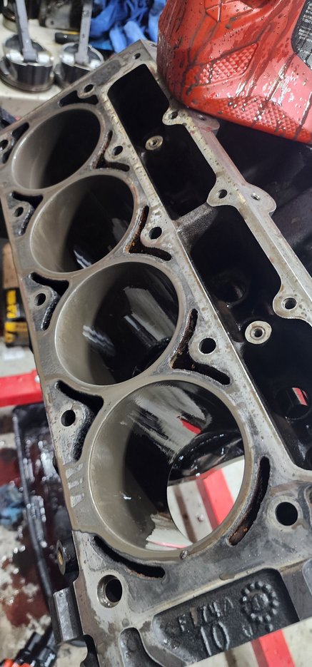

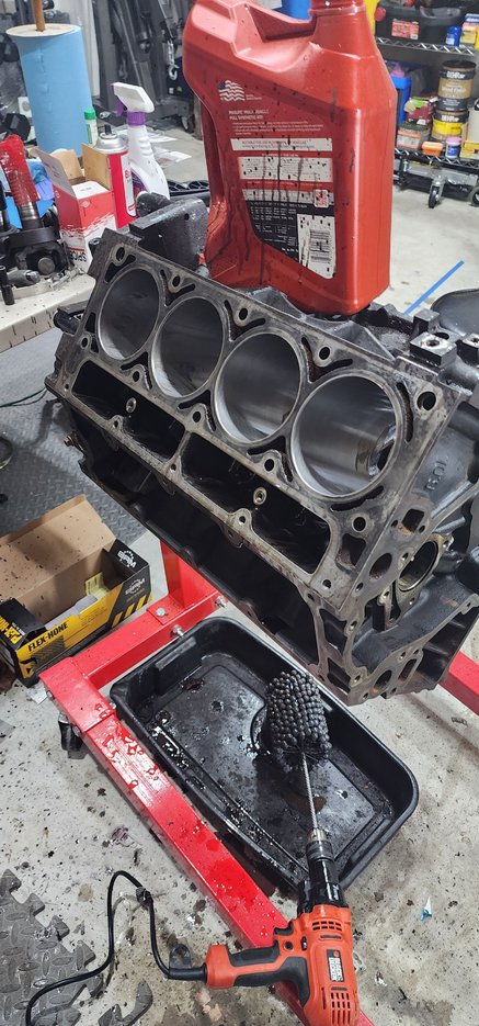

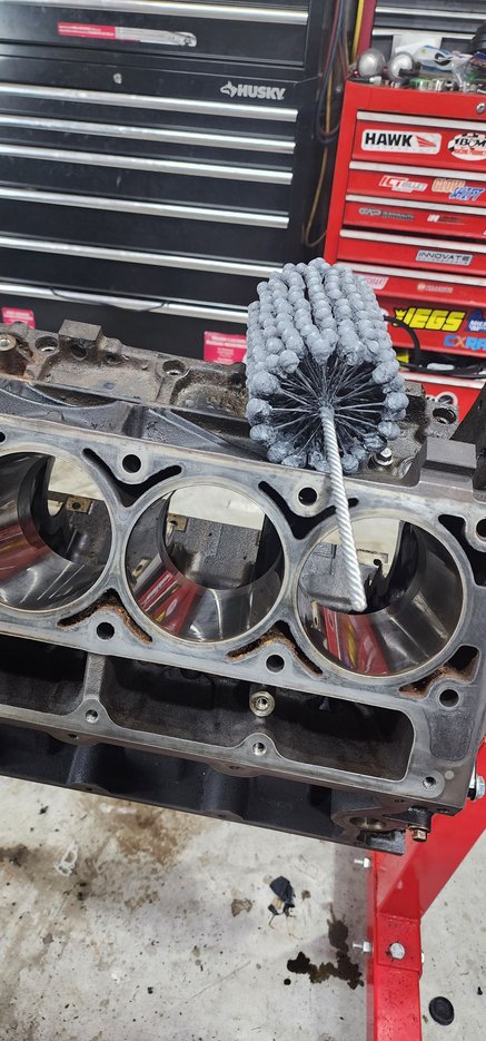

Ballhoned the glaze off the lq4 for fresh rings, and cleaned up the deck surface. one more cleaning before sticking the crank and pistons back in. The walls were mirror finished before, now they have a nice crosshatched finish for some fresh rings. I was going to throw the stock rings in it, but I think I over happen them a tad, so I got some new ones and a ring filer to do this a bit more correct.

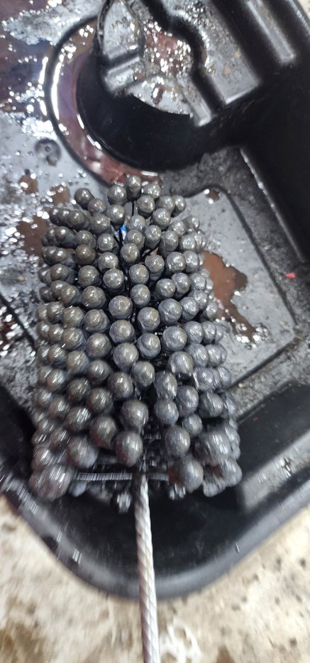

240 flexhone brand new out of the box. For a bunch of stock parts coming back together, this will do just fine. just look at those mirror walls, let's scuff em up!!! 😆
using atf for the lubricating cutting oil. not as messy as I thought it would be. don't get me wrong, it still needs a catch pan under the block lol

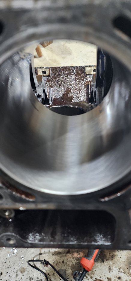

not too bad for my first time. 20 passes up and down inside at moderate speed at a constant pace and kept turning it on the way out to keep it uniform, and ran it on the way in.

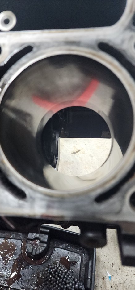

As you can see the glossy surface before the flexhone.
that will do flexhone lol
after doing a set of 4 at a time. i would splash fresh oil on the hone before each cylinder. then clean them all out, then fresh atf to keep it lubericated until i stuff pistons in it with assembly lube later. then I did the other bank.
not a bad crosshatch for a first timer. again, im just deglazing it. as you can see at the bottom slightly, it almost took all the carbon build up out where the pistons dont really touch the bottom of the cyclinder wall. not boring here, just cleaning up the walls for fresh piston rings with proper turbo gap.

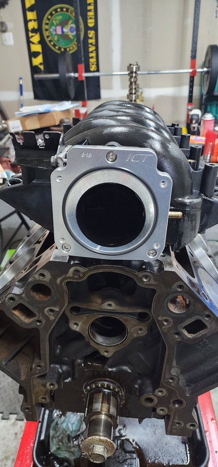

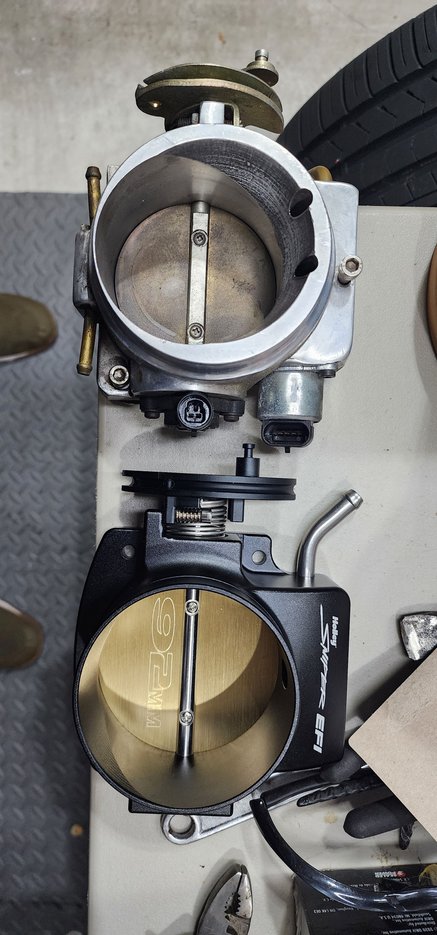

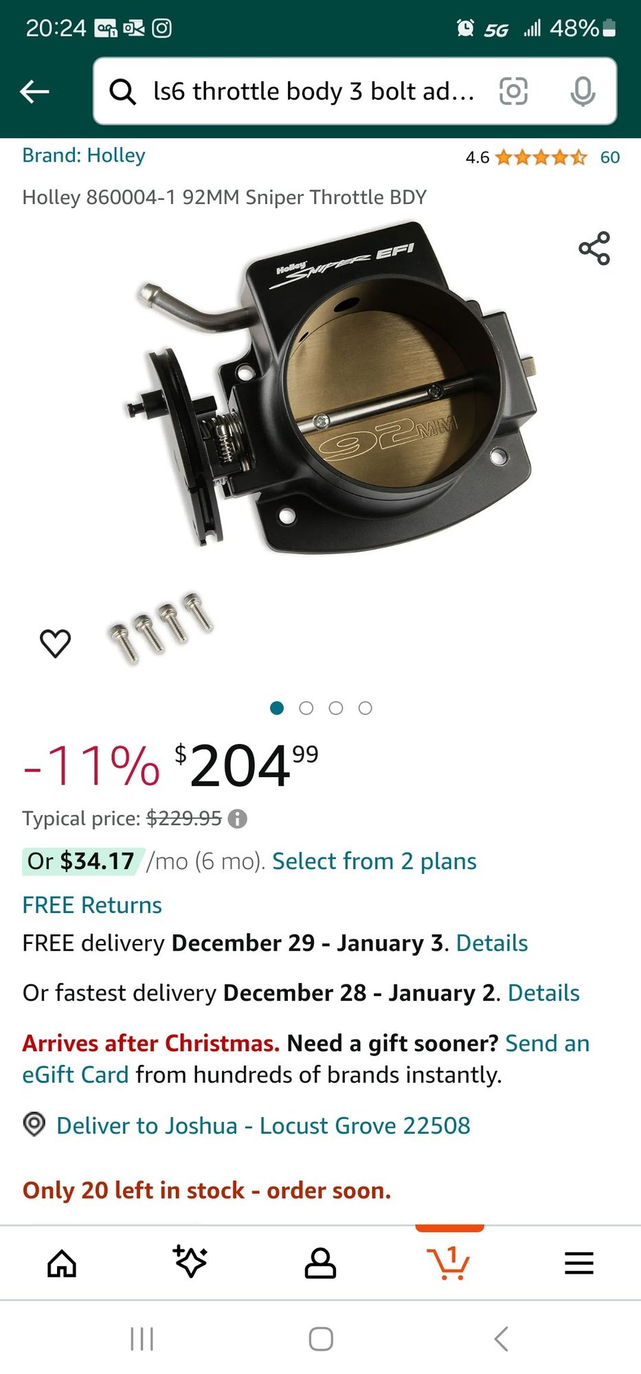

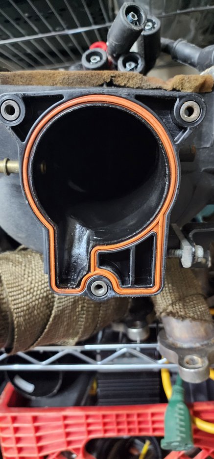

the holly sniper 92mm i was wrestling with getting it or not. ill be running an adaptor with the ls6 intake... yes i know the ls6 opening is smaller and wont benefit really flowwise, but i want to get something that will look cleaner than this ebay 80mm chunk of metal i got on the nose of the intake, and im pretty sure its messing with my tuning too. the holly sniper gets rid of the coolant tubes too, and if i feel froggy later, lets me run a spicier intake later.

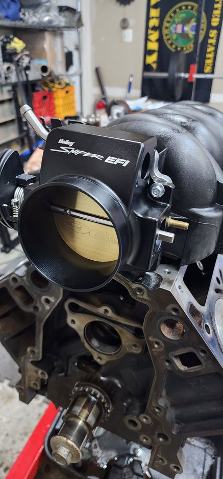

Holly sniper 92mm TB
Word of caution, need to get their sensors to fit in the TB properly.
