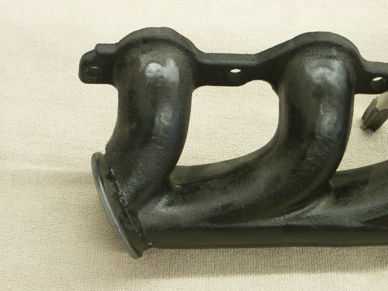

86 T Type.....I used a set of stock truck irons.. Worked well. May have some pics if you need them.

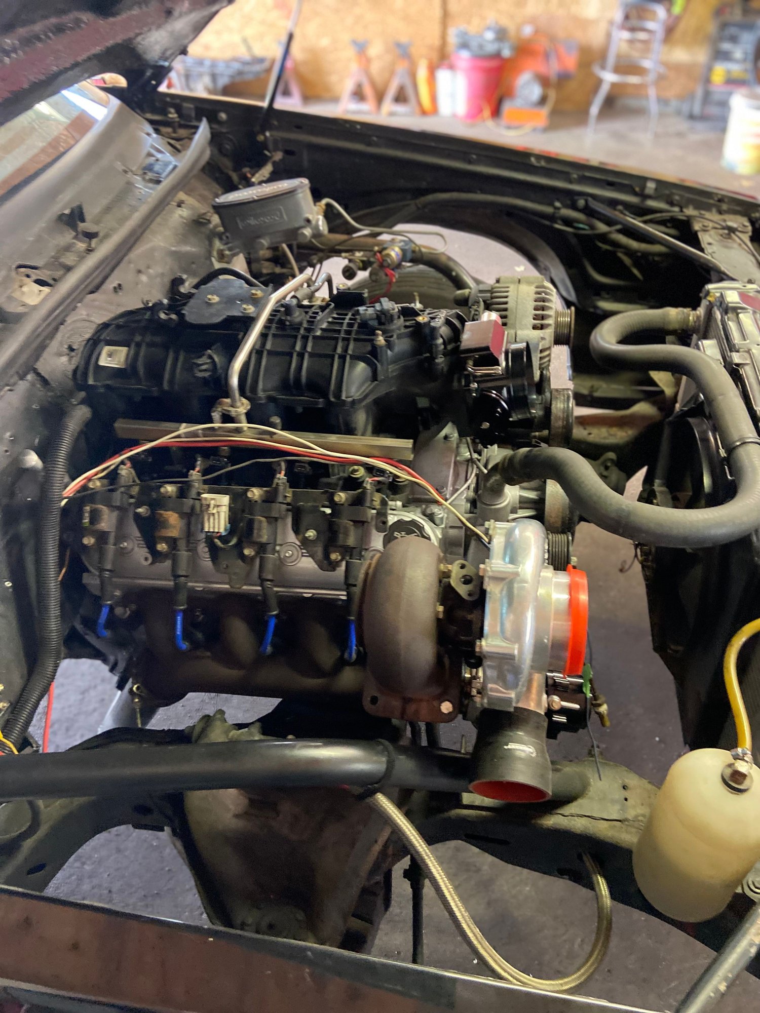

I used the cheap eBay style pass side log on mine with a stock truck drivers side manifold with the flange cut off and a 2. 1/2 v band welded on .
86 gn
