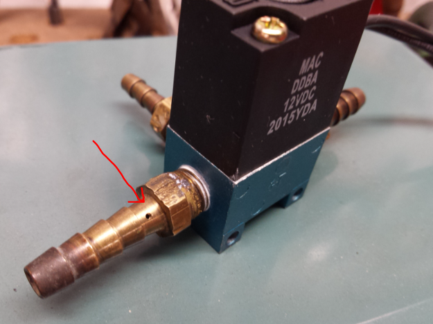

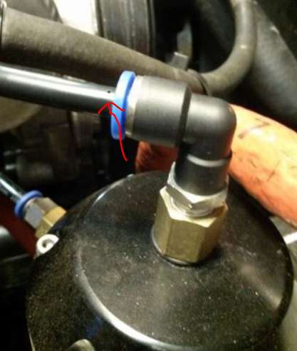

You can have rock solid very easy to control boost if you just set it up properly. The lower line leaks plenty around the valve shaft of the WG. If the top is super tight just put a small bleed hole in the fittings or even the hard line going to the top gate reference. You don't leak enough boost out to hurt a darn thing and control is very good in my experience. Done it dozens of times.

otherwise this whole thing is a good example of how overcomplicating boost controll can give you headaches. pid/pwm/co2? what for? trying to get boost in 200 rpm earlier? what for? a "manual" boost controller always works and you dont have to second guess it. two orifices, one adjustable (and be it by sticking wires into a bleed off hole).
Is this just something you do automatically on every build or is this something you do when boost control is erratic?
For twin gate applications, would you do a single pin hole in the main line or a pin hole in the line at each gate?
