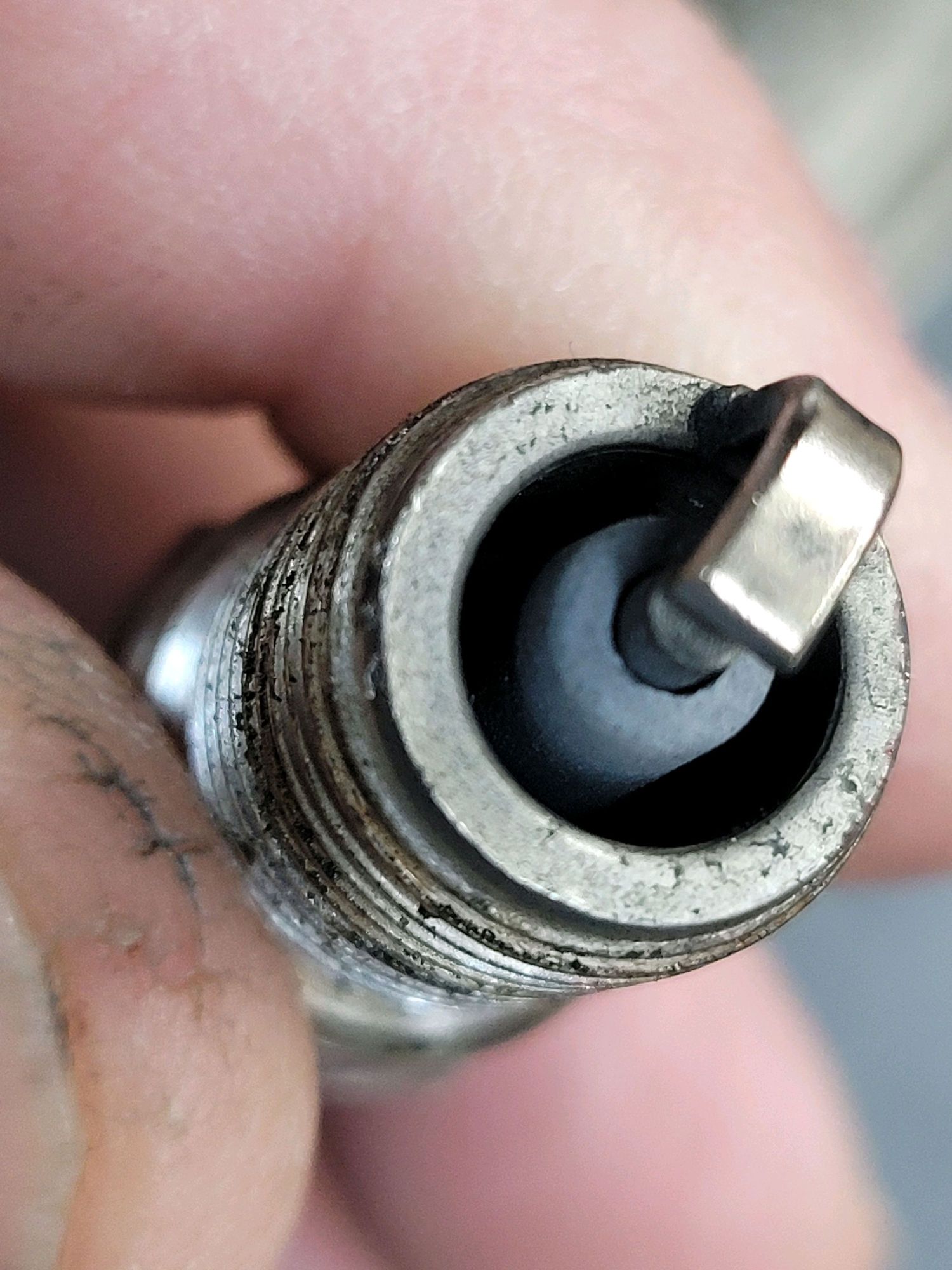

What do you think about this? I say it’s good and brother said it’s lean. Running on alcohol BTW.

Alky?? As in E85?
Application?
Plug part number?
Can't see the ground strap, so no timing info.
Looks like it's loaded with anti seize.
Porcelain looks to have been hot. Erosion around the pin.
How does this plug look compared to the other 7?
Reading a used plug is pretty much a crap shoot.
Need more info.

It’s out of a 2.3 turbo pulling tractor. But damn, I didn’t even notice the erosion until I inspected what you said.

Pull tractor... On strait methanol?

Yes it’s straight methanol. Timing is advanced 30°.

Cant tell much from that plug IMO. Run it clean with no anti-seize on it. Also you need a new plug with one pull/pass to redline and an immediate shut down. Fueling is hard to read on an alky plug as is. Prob not going to get the best response posting 2.3 tractor content on an LS forced induction forum.

Last time I ran METHANOL straight, I tuned with a DRILL index. Did not have a wide band O2, but you could HEAR the tune in the exhaust note.
Drilled main jet out until the wide open throttle sounded flat and blubbered, at 1/8", than drilled one next size smaller. Sharp, crackl-ey sound.
It was a 4-5/16" stroke Sportster at 13:1 compression, and I ended up with a .118" main jet in a 2-1/16" throttle body.
I never got any color on spark plug, and It ran about 18 mpg on the street. Traction limited in 3 gears.
Methanol is almost half OXYGEN by molecular weight, so you can burn a VERY LARGE volume of Methanol.
Stoich is around 6.4:1, but it has a pretty wide range that will make power.
