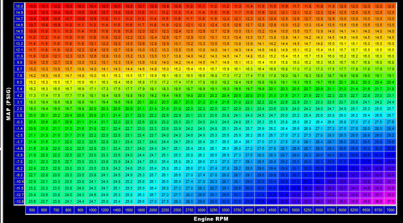

HNY! Could use a sanity check on my timing table. @ddnspider and others. Thanks!
5.3 JY stock bottom end and heads
LS2 intake
Cam: 216/216 .561/.561 114LSA
7665 .96 turbo
Dual TurboSmart Comp40 gates, 11psi
A2W intercooler
Straight 93 octane
Location: FL
I'd like to shy on the side of safety given pump gas. No issue finding 93 octane. I followed the Sloppy model when designing the spark table.
Appreciate any input.

One thing your table doesn't do is take into account rpm vs boost very well. For example, you shouldn't have a constant 15* timing across the whole rpm range @11psi.
I understand you probably aren't making nearly as much cylinder pressure as others, but advanced timing with low rpm and boost is how you bend rods and lift heads. Managing cylinder pressure is critical.
I would shoot to back it down a degree or two with every 1000rpm less. You're likely ok at 15.8* timing and 11psi at 6000rpm, but I would reduce that timing number to something like 13* at peak torque, and less as rpm drops more. You wont lose much power with this method, and if you want more just add another pound of boost. Boost is safer than timing.

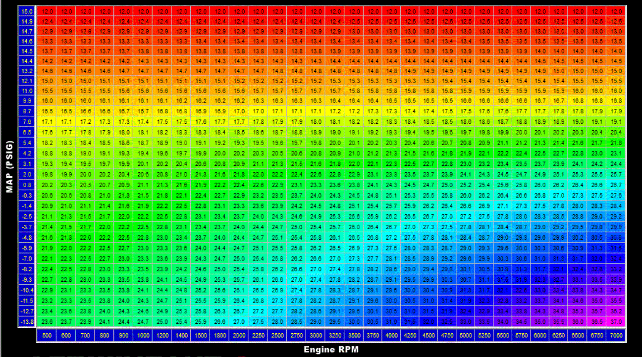

Thanks for the reply. I think I was struggling with this issue a little bit...and it makes sense. The cam likes timing at idle and cruise but I need to slope off the low rpm side of the timing curve at higher boost pressures.

Wow, ok, so I can raise and flatten the low vac, high rpm area of the curve, I'll work toward that. My cam at idle needs 23-24. Struggled to turnover below 20 degrees. I rolled over the low rpm, high boost area of the curve, feel better about it now. The 7665 turbo comes on quick, so there is more exposure/stress on the low rpm/high boost area of the curve. Thanks.

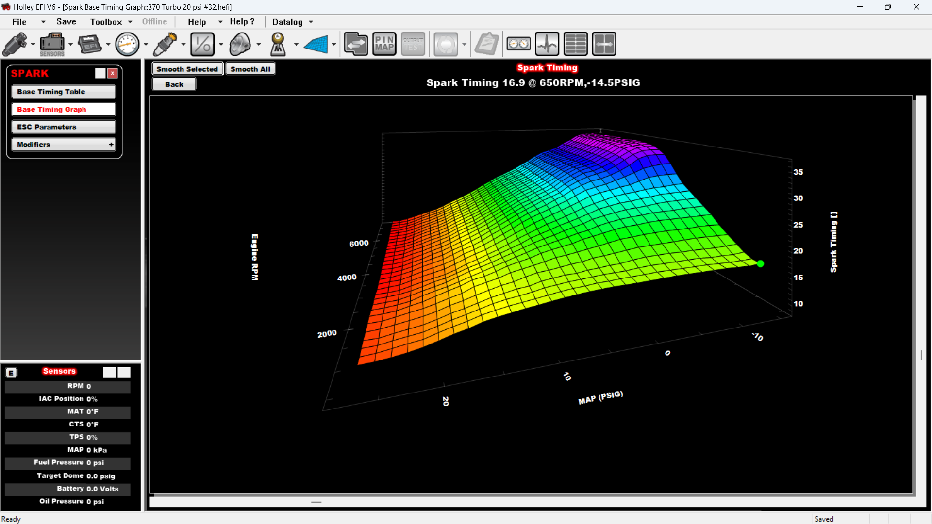

Update spark curve. Followed advice here: added idle and cruise timing in the high rpm, low vac areas. Sloped off the low rpm, high boost areas. I think everything improved across the board. Pulls hard, gets into boost quick, and my idle issues have improved. When I quickly blip the throttle, it was almost stalling. Not perfect, but now snappier and rev happy. I'll have to run more logs but I observed no knock. The learn asking for way more fuel now, which is great.
