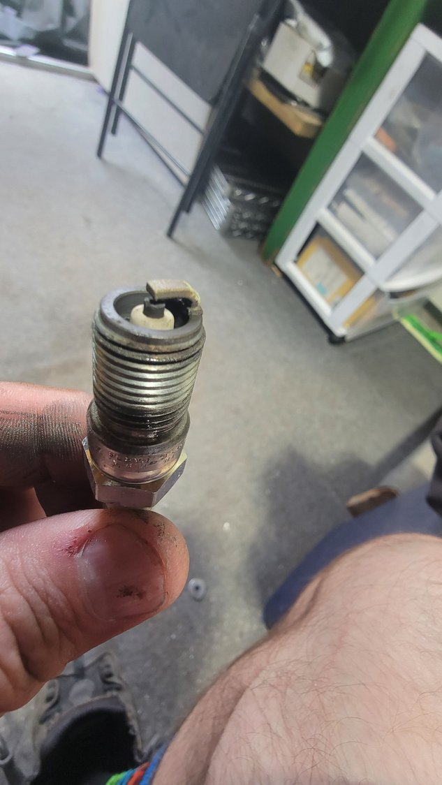

Kfxguy,, thank you for your input. I have about a month before my schedule Dyno tune, I'm a little nervous i went with to big of a turbo. At the time i was getting a good amount of suggestions to go that route because of the engine displacement (398ci).
that turbo isn’t too big for that size engine. You’ll be fine.

i hope not, btw by "to big" I'm referring to not being able to start making power from around the 2-2500 range. i have a Vs racing 80mm with The v clamp, turbine housing A/R is 1.30. So far i am not impressed. But I'm hoping it is because of the tune.. more so the spark advance isn't correct.

" more so the spark advance isn't correct."
What do the plugs say?

i have not check, once i got the "basic" fueling close, i planned on putting a new set in. Which will be happening before I take it back out to continue with the tuning.
Current plug, #3cyl
