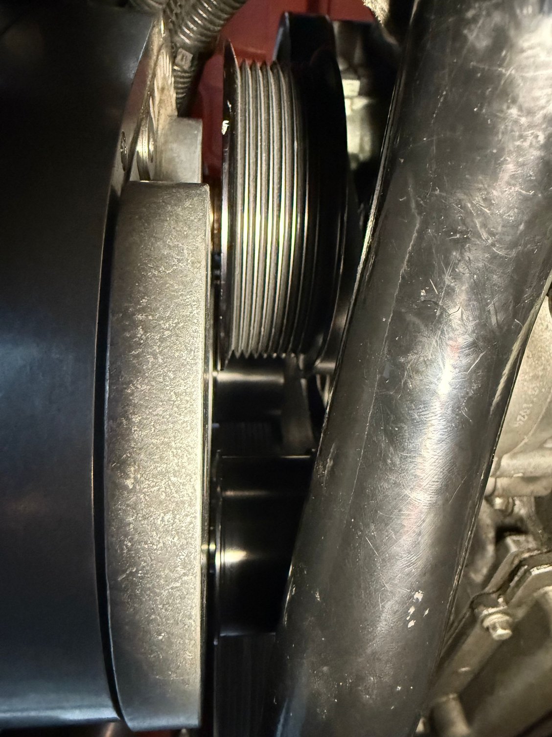

I responded to your message as well but will add it here for benefit of others. It was actually the opposite. The bracket is thicker in spots but actually moved the blower closer to the motor. I found this out because the blower pully actually hit the alternator at first, and I had to remove a couple of the pulley spacers.
Here are some photos
Here is the spacer issue and a few other random photos
