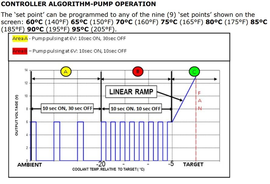

Right now, the Davies Craig controller controls both the fans and the water pump, I was trying to not put too much on my plate with this project, so I opted to leave the DC controller in place for now since it works fine.
According to DC the controller for the water pump which mine is the EWP150, varies the voltage from 6v to full battery voltage and pulses the pump on and off based on temperature, see example below.
If could just wire the pump directly into the Haltech then that would be great, based on what I'm seeing on the DC website, the EWP150 is not brushless though.
I do have some 40amp relays on hand so I could put together a harness for the pump pretty easily, it only pulls 10 amps at full song.
Now if anything, I could really care less about the pulsing operation and would be fine just triggering it at full speed at a given temp with the Haltech.
