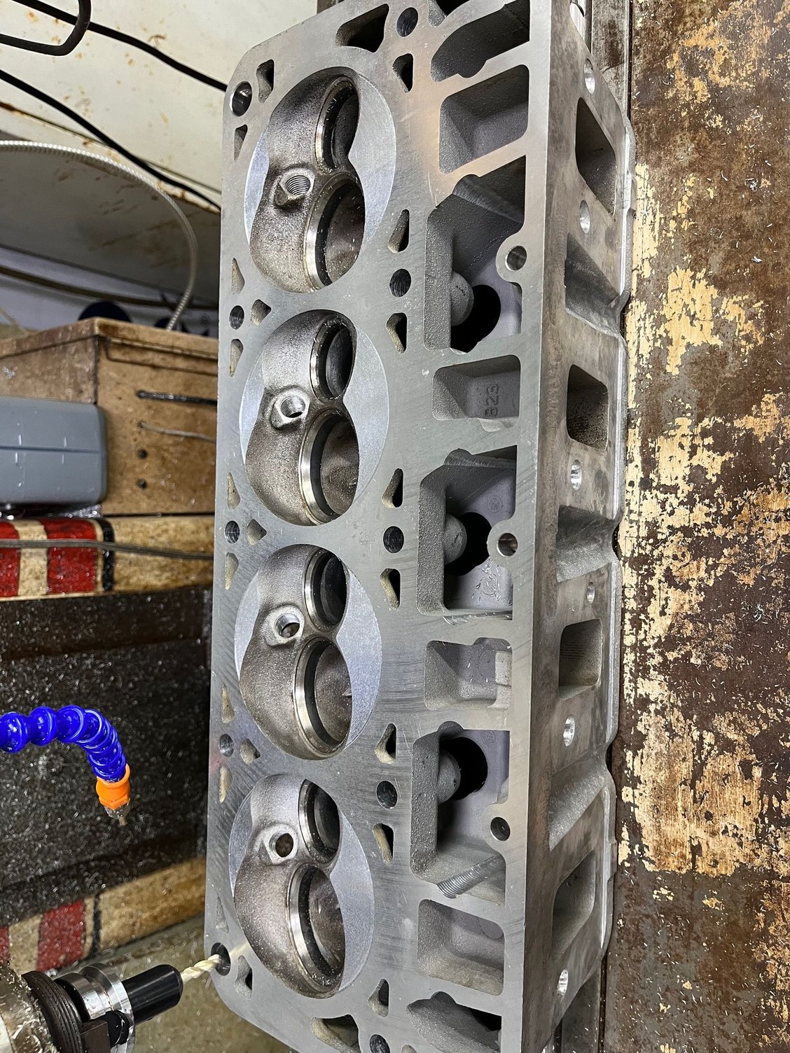

Guess I will just softend the chambers (5°-7° layed back angle) and put some BTR small bore LS9's in her and see what happens.
Will net me roughly 9.5 SCR and a 0.047" quench.
I will quit trying to over think it...like the N/A racer that I WAS.

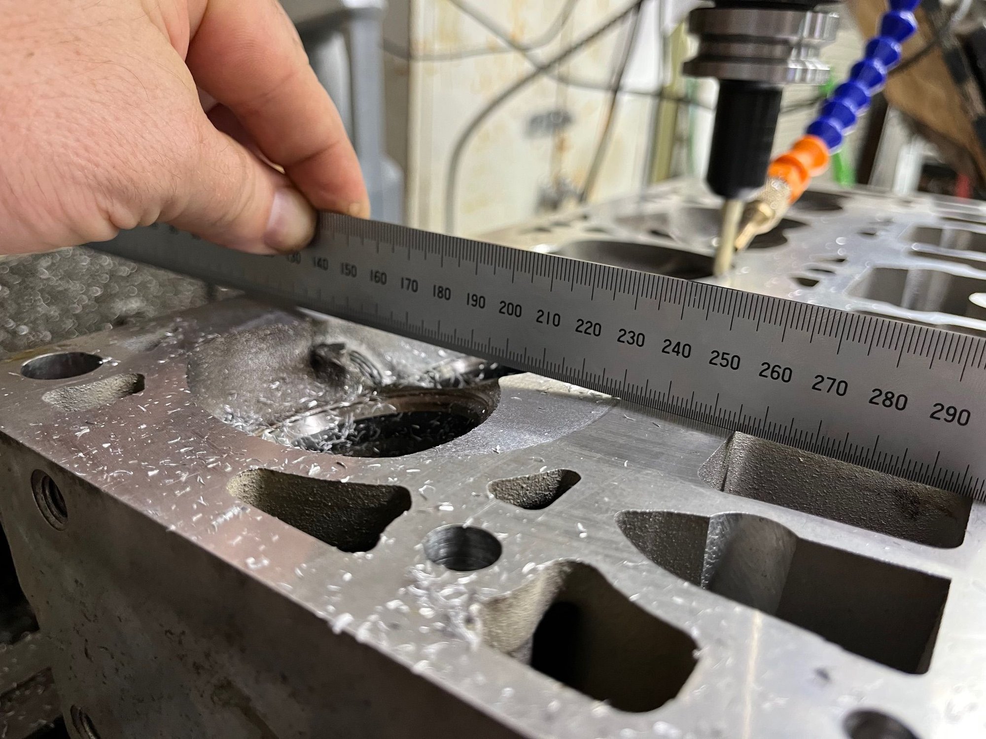

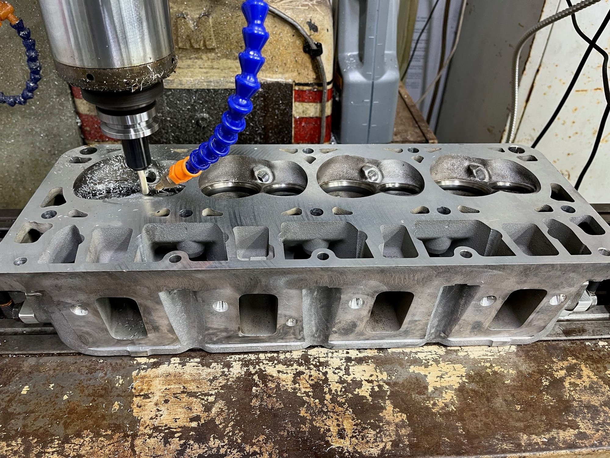

Is that a manual mill? If so would love to hear how you performed this job, I am working on the same.
