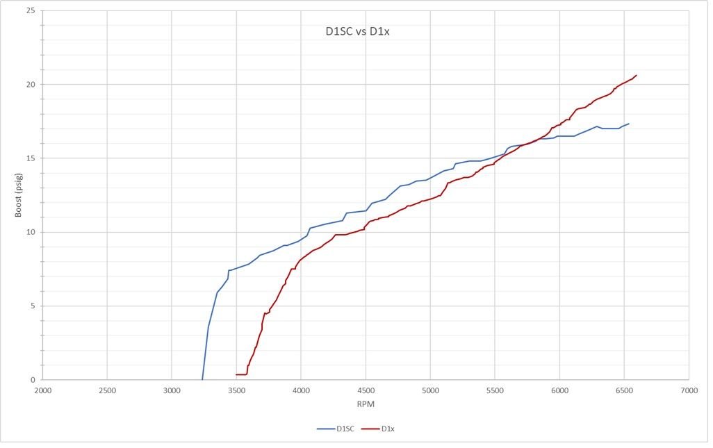

Please take a look at my boost graph here. Notice how the boost rises and kinda starts to fall off some up top. This pull was to 6650 rpm and boost was 15.1psi.
Should I be concerned?

This is kind of what it should look like. The below graph is an amalgamation of many runs of D1SC and D1X on 380-ish to 420-ish ci motors. Neither fall off at the top. You probably already know this, but stuff to check.:
Belt slip - its always belt slip. If new belt, check alignment. I align within 1mm from crank to S/C pulley offset and 0.5mm plane-to-plane. Make sure your tensioner isn't too old. I have pretty good luck with no belt slip if I keep the alignment tight, annual belts and new tensioner every few years.
Valve instability (will show up as a sudden lean). Unlikely
Your intake piping or filter getting sucked closed.
Boost piping opening up under boost (ie partially torn silicone transition).
Bypass valve opening under boost (ie. not enough spring pressure)
There are handful of other things, but I think those are the usual suspects.
