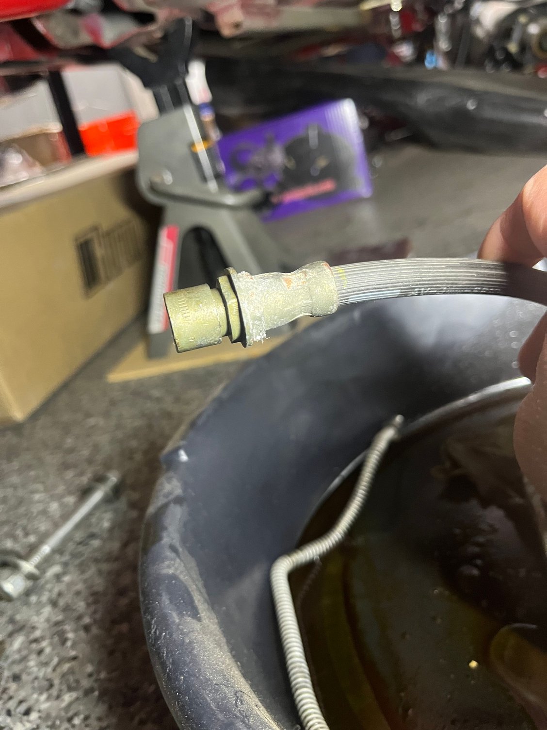

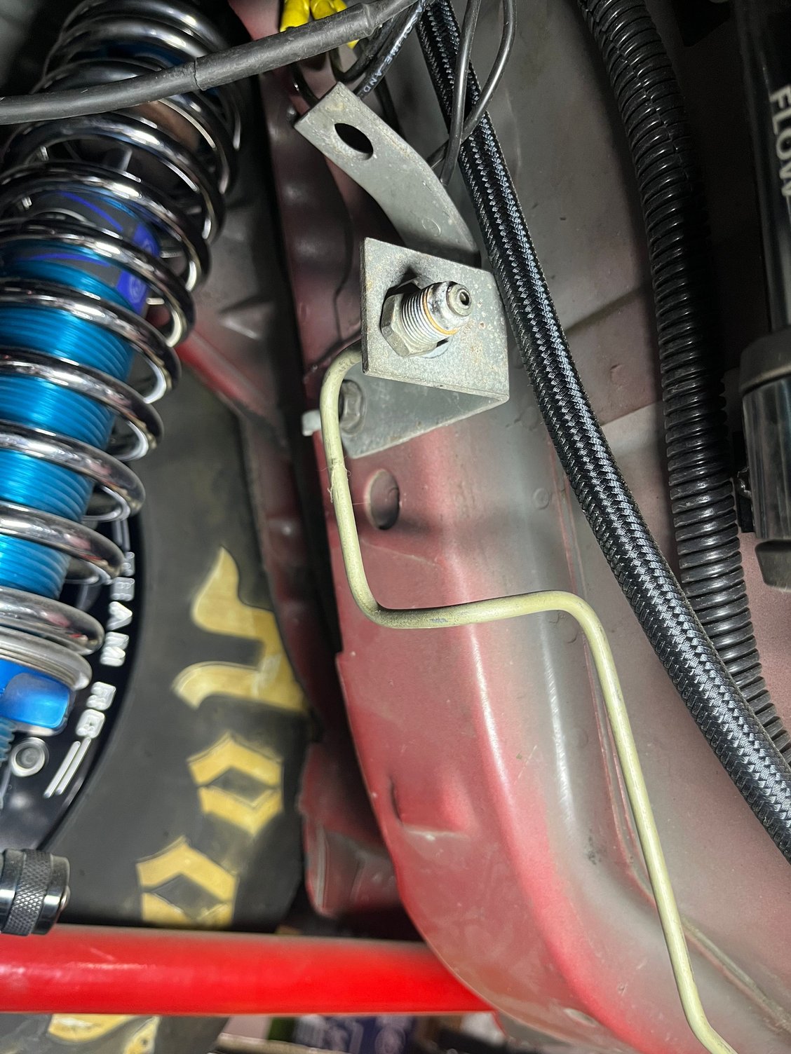

I’m only posting here because the brake section gets no traffic. Does anyone know the size of this brake line fitting? I thought it was 3/8-24 and ordered a hose with a bracket to fit the 9 inch center section but turns out it’s the wrong size. Thanks in advance.

Probably M10x1.0

I searched and read either M10.1.0 or M12x1.0 but said depending on traction control or no traction control and my car is a no traction control. So still not sure.

What size is the nut? I can tell you for sure in the morning. On my vette, the only M12 connections was on the ABS module. The rest were M10.
This is the hose that goes on it, but the size of the wrench for the fitting is 14mm.

bubble flare is always metric
if the hex is 14, then its M12
