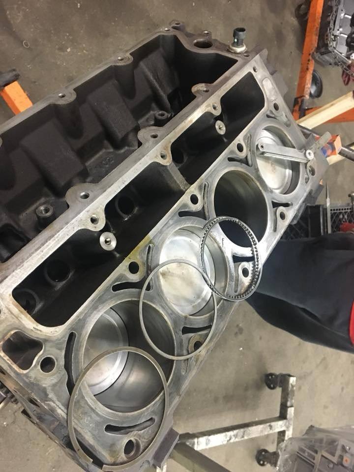

For my SBE gen 3 LM7, we gapped the rings, and reused the bearings because they looked great. Also did a cam (Baker Engrg) and valve springs. I also had the heads decked but they were from a different engine and we didn't know the history on them.

As John and others have said, at best I would check the ring gap and adjust as needed. So at least .006 Per inch of bore. So that's .024 for a 4 inch bore. Add .002 to that value for the 2nd ring.
A huge point of contention is cam bearings... Now, I have the tool, So for me it usually just the cost of a set of cam bearings. Unless they look good and I leave them... Most of these engines are 20 Plus years old. I can't recall the last time I saw a good low mileage engine that I left the cam bearings in.
Other than that, I would just reseal it with fresh gaskets So you don't have any leaks and let her eat.
