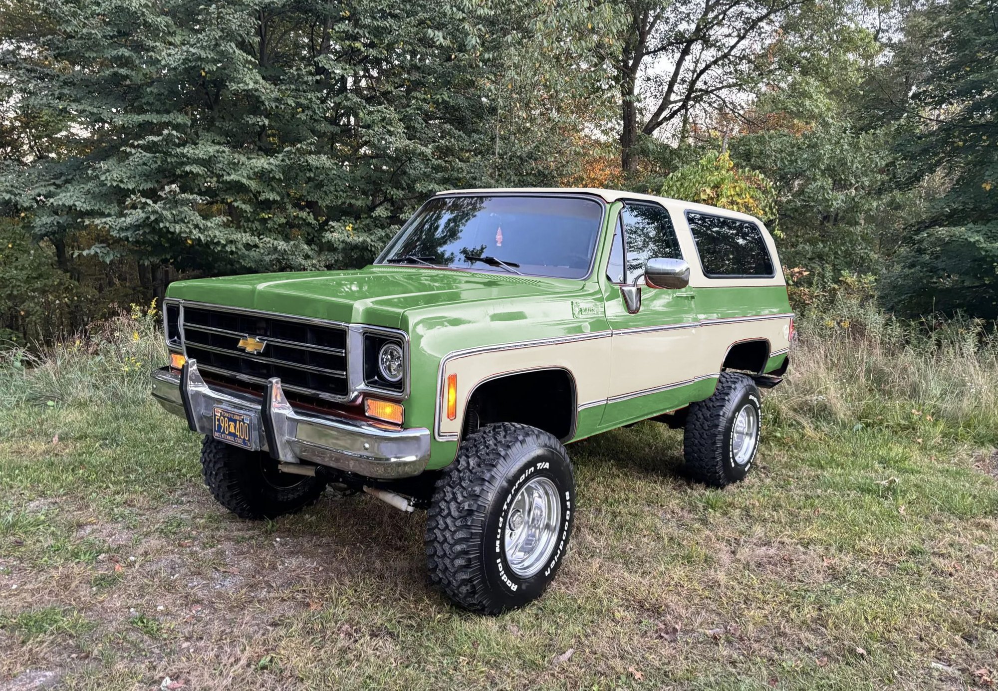

That's a gorgeous K5 my friend.

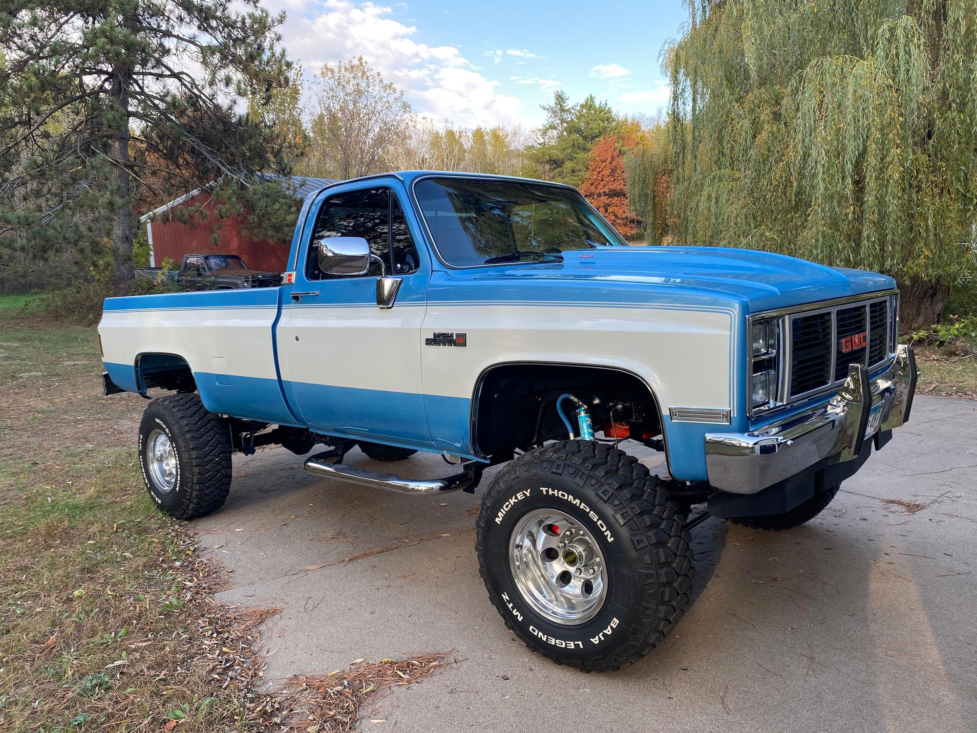

I confess that pic is just my photoshopped rendering of the end goal, but I'll share pics when its done. Just for fun here's my other truck thats taken me about 2.5 years to build.

I had one of those!
It had a BBC 454 with big oval heads, it would light the 35's at will and got 5-6 mpg lol.
I loved that truck but I put two or three cams in it because it sat all the time and it kept flattening cams, so I sold it to a friend of mine.

Nice!! This one has a Gen 6 454 with the roller cam. I built it to be mild and reliable but now I wish it had more power...lol. Sounds like you're thinking what I was thinking. VS7875 might be the sweet spot with an a/r around 1.10 or similar. Last time I looked I think they even had a few turbos with that T-51r mod to make the whistle louder. That would be fun.
