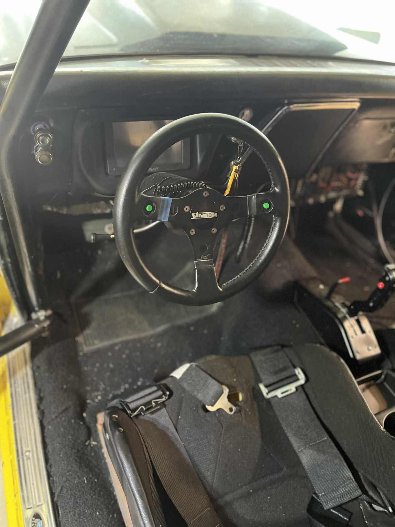

Maybe someone makes a bezel for the 4th gen? I've got the Holley screen in my '67.
