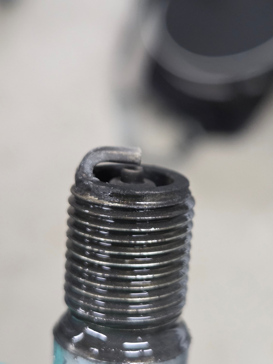

I recently pulled my plugs (BR7EF) to regap from .026 to .022 to try and eliminate a choppiness in rpm on the top end which I thought may be spark blowout. When I pulled the plugs they all looked very similar and all had oil on the threads. Wondering how oil is getting into the cylinders and how much of a problem this is.

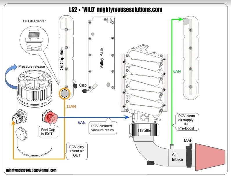

Mightymouse gen 5+ catch can setup with 12AN hose running from valve cover to can, plumbed as shown:
