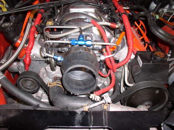

Originally Posted by Moparnos (The SLP Guy)
mr hawk can you post a pic?
Here you go SLP Guy
These are some shots of the plumbing I did for a buddy, on his HUGGER. (HUGGERS ORANGE SS)
(note missing rh jet union used for mockup.

Yes I love my Meth setup you did Chris... Again looks awesome!!
I have thought about having the IAT sensor after the Meth Spray.. One place I believe could be placing the IAT sensor on the back of the intake for my Weiand Aluminum intake.. My Meth spray jets are only 1" away from the TB blade and it sould be almost impossible to place the sensor aft of the Jets..
