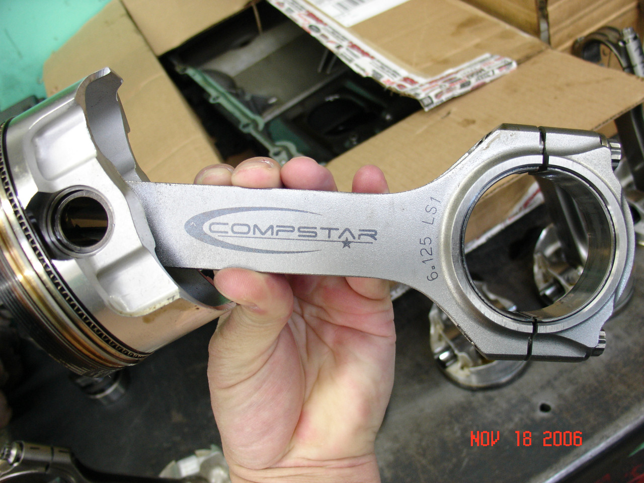

edit: What rod length is that btw? lol

Not sure how much sleeves are. Going to ask the builder.
Here is the pic of the rod.

Same rods as me
