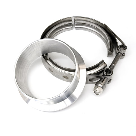

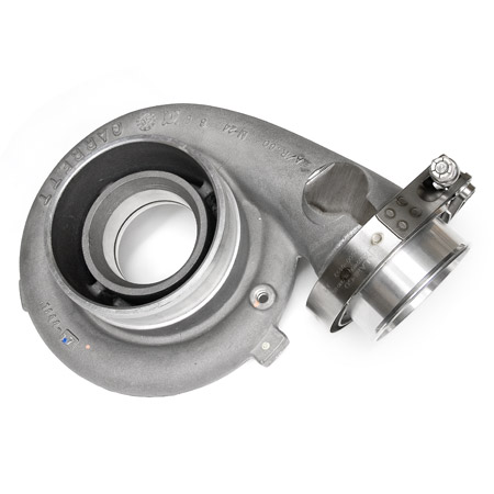

My GT47 has a v-band outlet on the compressor. Are there any places to buy a flange and v-band that works, or do I just get a 3.5" aluminum v-band kit and use 1/2 of it
I found a source for the 5" turbine outlet, but haven't found one for the compressor yet

Got mine from precision turbo, but you can get em from atpturbo. ATP sells a real nice flange that has an extension to slip a silicone connector over it.

Problem I have is I can get a whole aluminum v-band kit (2 flanges and band) for 53.00
(or can order flanges for $22 and the band for $11)
That thing ATP sells (just one flange and band) is $69.00
Does a standard 3.5" vband flange work or is there something special about the GT42/47 that requires a different flange?

The one from ATP and the one from precision(the one I have) both have a locating flange(inner, slips into the compressor housing) and are O- ringed, so they are different than a standard 3.5 V band. Will a regular V band flange work, probably but not too sure.
J
ok...I was afraid of that. probably will go with the ATP setup. The precision one I found is $$$

wolfe's bands are intended to connect 2 pipes it appears. I'm pretty sure frcefed is correct, I recall seeing a locating flange on the compressor outlet which most v-bands dont have a provision for. Better safe than sorry
Wolfe does have some nice 3.5" to 4" v-bands which I will use for my IC connections (I'm running 3.5" piping and the IC I have has 4" outputs)

I ordered the ATP kit. Shipped out the same day too
We'll see how it looks when it arrives

decided to put on the TB too. a 4" v-band interfaces with the TPIS 90mm pretty good
That ATP kit is pretty nice
