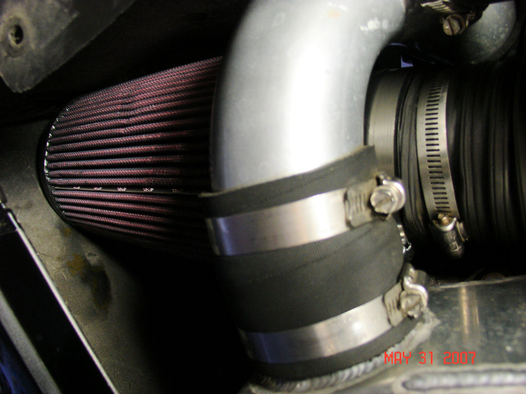

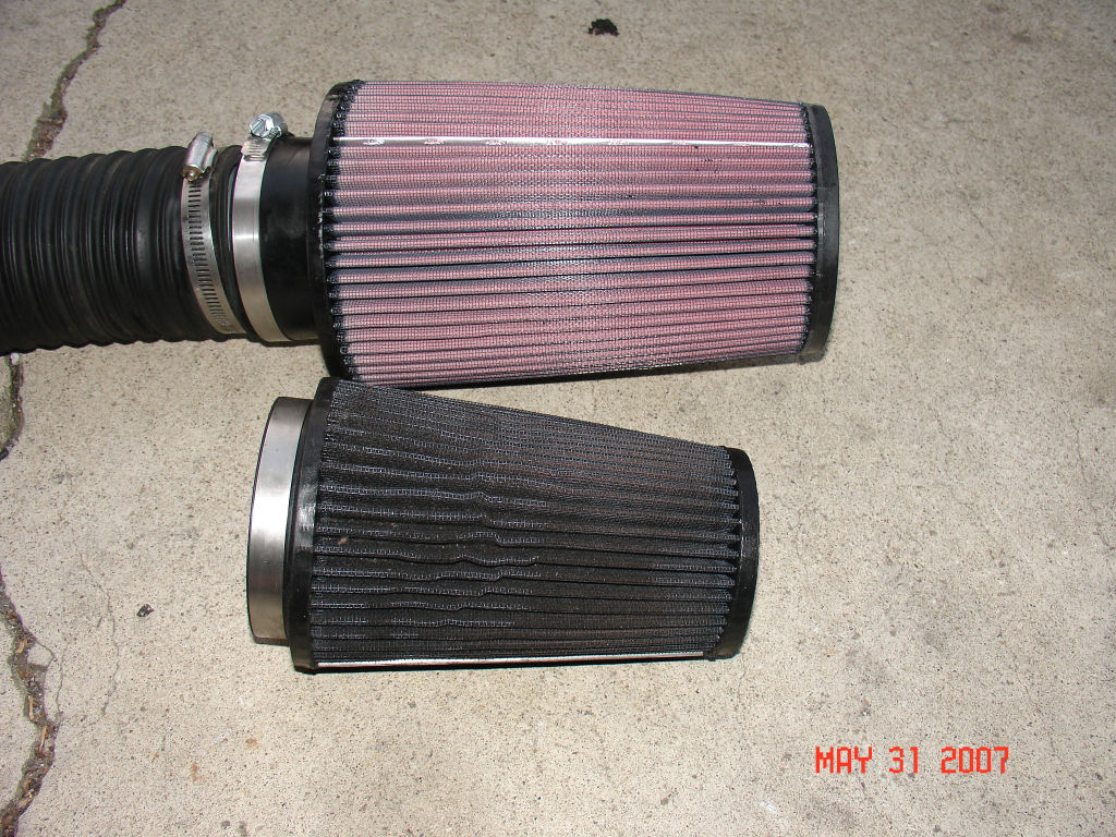

From: Sunny San Diego
Originally Posted by Bad30th
Yeah Ed, let me know how that bigger filter fits, I may get one too.
I also have a smaller K&N filter on the bottom of the inlet hat where the BPV return goes (and vented the BPV to atmosphere). If you want I can get you the part number.
Rob (Bad30th)
It fits, but its a tight one.
As you can see in your pic #2, it does push out the bumper slightly. But in the end its worth it. I saw at least another pound of boost.
Simple!!!! 5 minute install.

Weird... I just got mine in the mail yesterday. Haven't had a chance to install it yet tho. If the filter alone doesn't add any boost, then your restriction must be in the hat itself. If I don't gain any boost, then that is the next issue I am going to address...
I guess I will change that out too. Who sells it?
Well, no one sells anything that will fit in there if you still have the A/C and radiator in the stock location. Thats what sucks You gotta fab something up special. Either move the radiator forward or remove the condenser or do something else to get a 90° elbow on the front of the head unit.
I was thinking of making a hat that would have two sides on it so I could run 2 filters off of it, but I'm not sure if that would remedy the situation or not. I don't know if the restriction is that narrow area between the radiator shroud and the head unit or what? I'm planning on installing my filter today. Hopefully I can find out if the filter alone worked for me, or if I am going to have to go through with plan B...
Well that sucks I don't plan on moving my radiator. I didn't see any increase in boost with the new filter.
