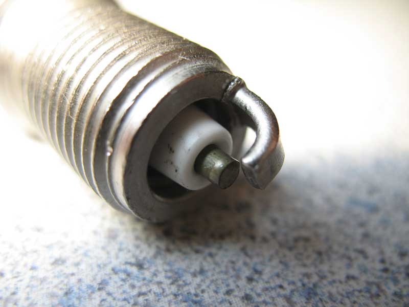

its not so easy to see in this pic. But these Racing Iridium Denso's use the electrode I was talking about too. Its straight, and mounted at an angle towards the tip of the plug.

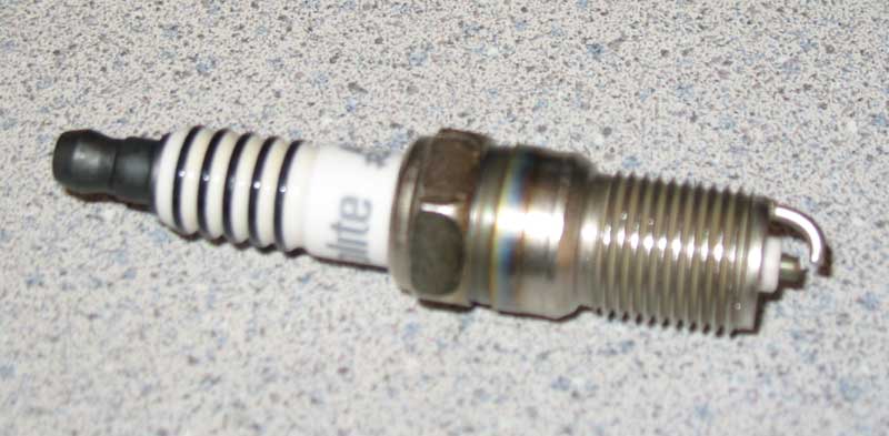

I use the AR3934 plug's. Autolite Racing!

Originally Posted by Superado
I normally use the NGK's,but the Autolite's are a normal stocking item for Advanced Auto.

Old Nov 19, 2007 | 05:18 PM
HUNTER02SS's Avatar
iTrader: (24)
Joined: Oct 2006
Posts: 2,796
From: Kennesaw, Georgia
Cool, Thank's. My only concern after looking at the link's you posted of the different plug's is my plug's electrode's are recessed and MM,KP's are protruding,but both set's are heat range 8, I believe. I think the range 8 with the prtruding tip would be better? Not sure though.
