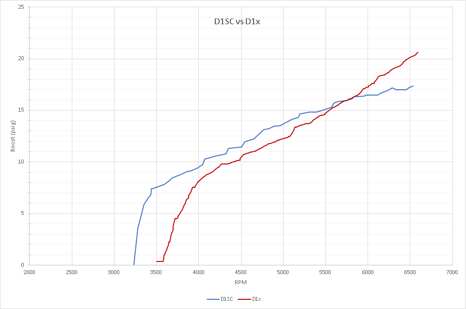

Agreed. You can make 900 with a D1SC. It is A LOT easier to do on a D1x.
For those interested, I put this up a while ago. You can see the difference between how a D1SC and D1x build boost - and why it is a lot easier to hit a higher HP number on the D1x. But, you do lose a moderate amount of low end with the switch.
These are two boost curves corrected to 70 deg F ambient. This is on a car where everything else was the same and just the blower was swapped. Same pulley, same everything - both spun to 62,000 rpm.
