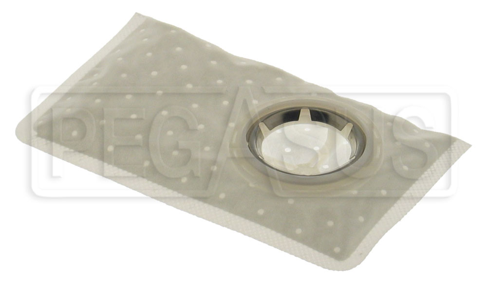

anybody got another source for the filter sock that can mount to the bottom of this puppy for use in-tank?
like this but with a reasonable price tag?

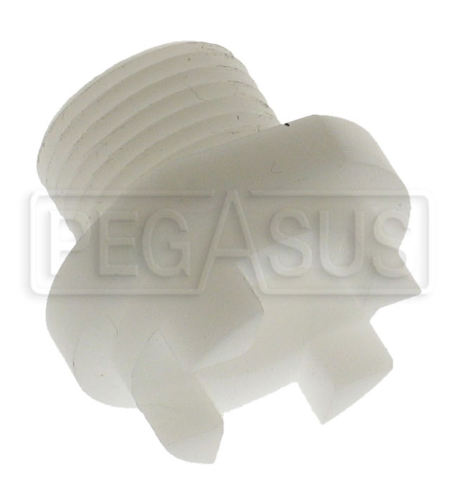

You can use this:
http://www.pegasusautoracing.com/pro...asp?RecId=5812
and this
http://www.pegasusautoracing.com/pro...asp?RecID=5813
Although it's about the same price.
Doing a little searching, the AN fitting on this filter is an 18mm x 1.5 to female 1/4" NPT fitting with the Fuel Safe filter sock (linked above) stuck on the end.

hmm no kidding, well makes it seem less valuable but hey whatever gets the job done
