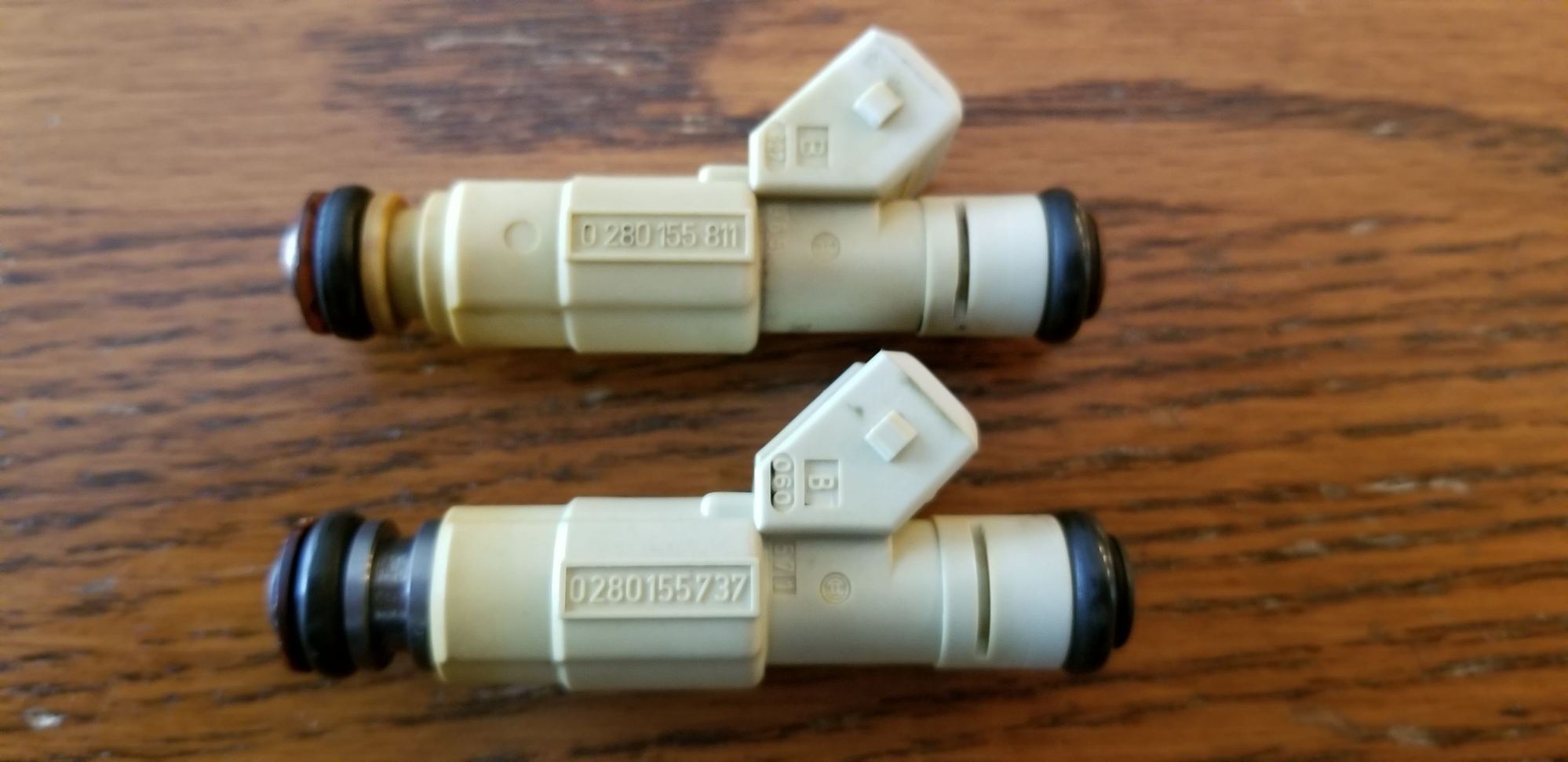

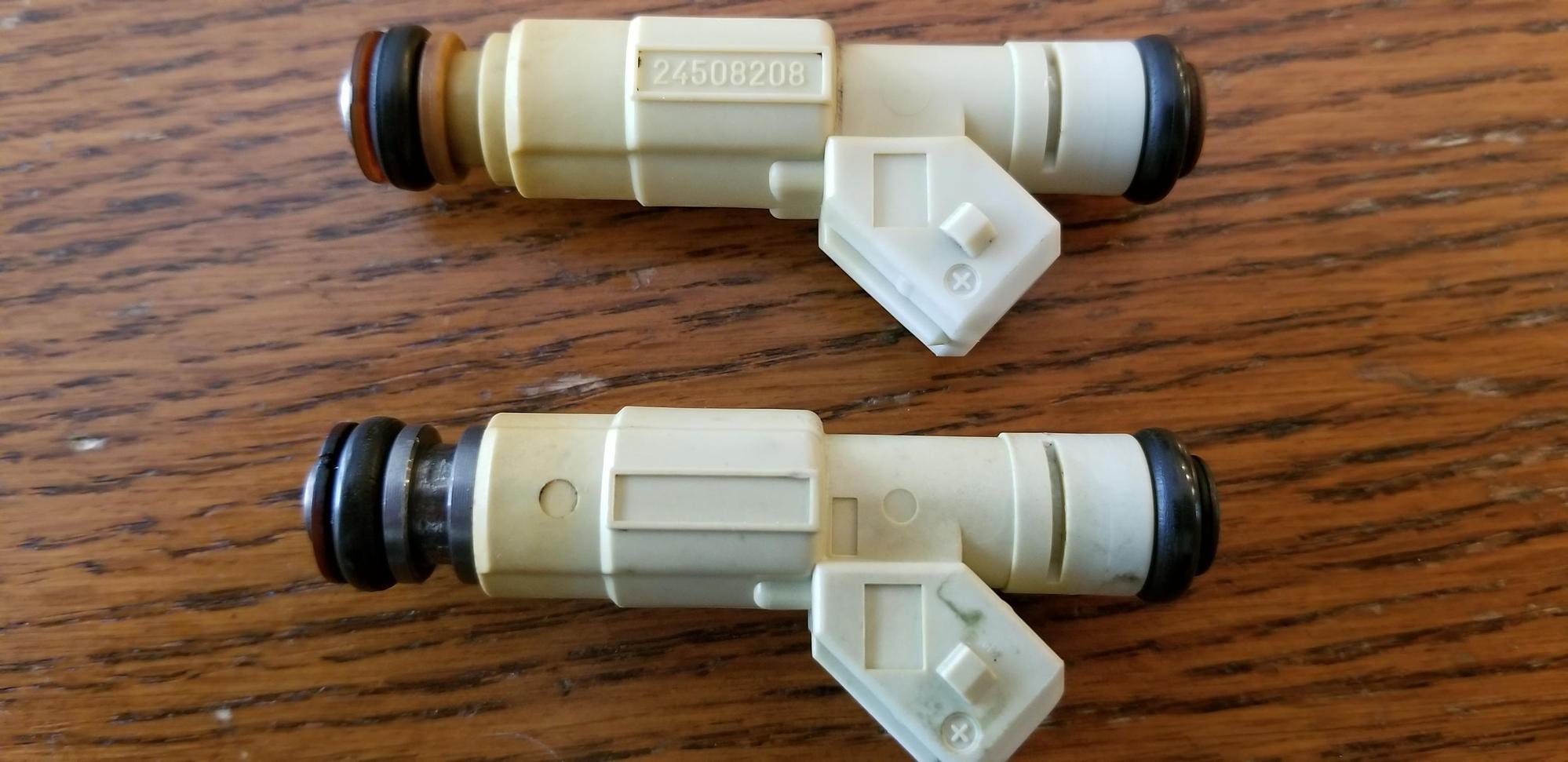

I just bought a set of 8 Bosch 36# injectors and I'm a bit concerned. 6 of them have part # 0 280 155 811 and 2 of them have the part # 0 280 155 737, they also look slightly different.
Are these injectors interchangeable? Will I be safe running a mix of these in a cam only LS1?
pics for reference

They're the same.
And they aren't 36#. They're 42# at our fuel pressure of 58psi. I ran these myself on my old HCI Camaro that put down 460/420. I was at 77% IDC with them; optimal.

Thanks for the information!
