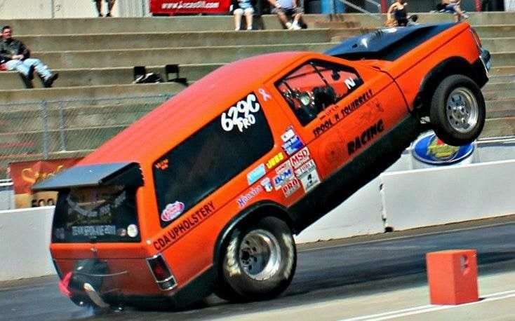

Joe nova: I’m gonna tel you that torq is not an issue cause other than the intake this whole build has been a good reliable set up for the strip. The only thing I am changing is going from blowthru to efi. I have been running the set up for over 6 years and have not had to replace anything, and on the carb it was putting down over 800hp but I dialed it to run 9.0’s here is a pic to shown that torq is not an issue.
