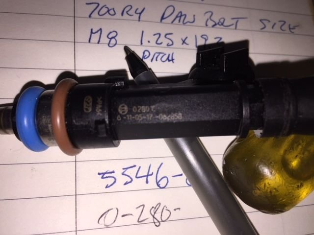

Bought a set of 36 pph at 43.5 psi and the vender supplied offsets are suspect, would like to know what others are using. In fact the Bosch part number has been defaced off all injectors- would not have purchased if I had known. In the past I've had no issues looking up offsets.
- Bosch long body gen 4
- USCAR plug
- pintle cap with 4 hoes
- 36 pph at 43.5 psi, 42 pph at 58 psi
