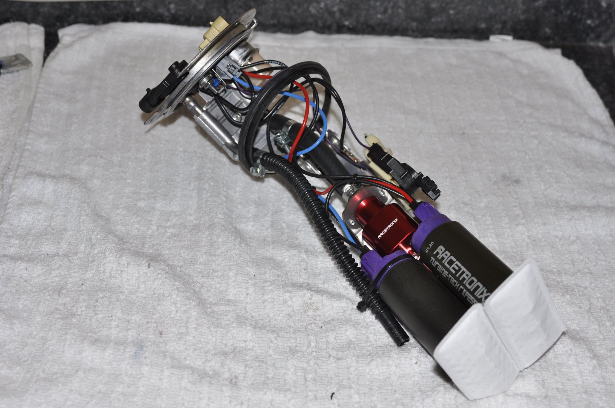

FYI:
Racetronix uses two of the four pins on the yellow connector for their dual 450 pump kit (98 only - it's not a issue on the 1999-2002 models with the upgraded connector). Each terminal on the yellow connector handles up to 14 amps which is adequate for each 255 pump. Each pump has it own relayed wire harness from pump to the alternator. A grounding post is drilled in the hat of the sender for the two pumps. The two ground wires from the two pumps are spliced into a single ground wire and it is attached to the vapor side of the grounding post. On the atmosphere side of the post the ground is inserted into a short harness that runs down to the relays.

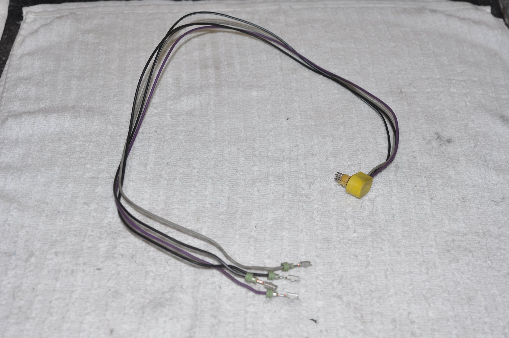

This is what your harness probably looks like. Mine is a 98. I suspect yours looks the same. The grey wire is power. Racetronix supplies a plug end for it so you can splice your existing harness into the plug and plug it in directly into the yellow connector.
The new connector plug is hard to install. Use a correct sized socket to press the retaining metal clip onto the vapor side until it is tight. Might want to get two, as I bent the crap out of the metal retaining clip on my first attempt. Using a socket allows you to tap it on without bending it.
As you can see. The same yellow connector is used for two pumps on my dual 450 kit.
