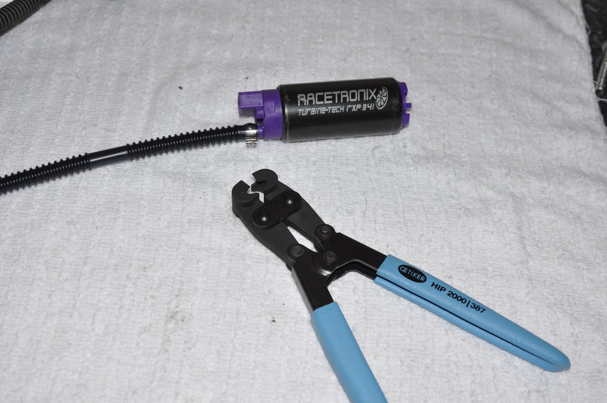

In the instructions for the Racetronix FPA-001B, it says use fence pliers to install hose # 27. I'm not sure what they are and are they necessary ? Can I just use a hose clamp instead ?
Old Feb 22, 2019 | 01:36 PM
Posts: 22,289
Likes: 3,615
The pic shows exactly what they are. A pair of edges to crimp down on the soft clamp to compress the hose being crimped.

You can also use tile knippers or otiker clamp pliers or carefully use a pair of side cutters. If you use side cutters make sure you crimp it from each side.

CV boot pliers.

The Oetiker clamp is a one-time only clamp. You only get one chance to install it. So use the correct tool to clamp it down. An Oetiker tool works best because it allow you to pinch the clamp from the side or from the top.
https://www.homedepot.com/p/KNIPEX-8...E&gclsrc=aw.ds
The Oetiker clamp is metric size also and not as easily sourced as standard size. None of the standard sized Oetiker clamps at Advance Auto for example will fit as they will not clamp tight enough. The clamp is also hard to remove as well. I found a Dremel cut-off works best.

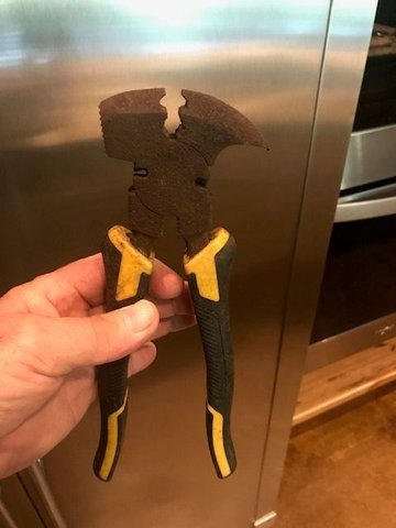

Here is a fence tool or you guys that never put up or had to fix a barbed wire fence.

I have used that to mash the clamp and it doesn't work very well. It is OK on the tiny /
1/8" clamps but not on the 8mm clamps.
