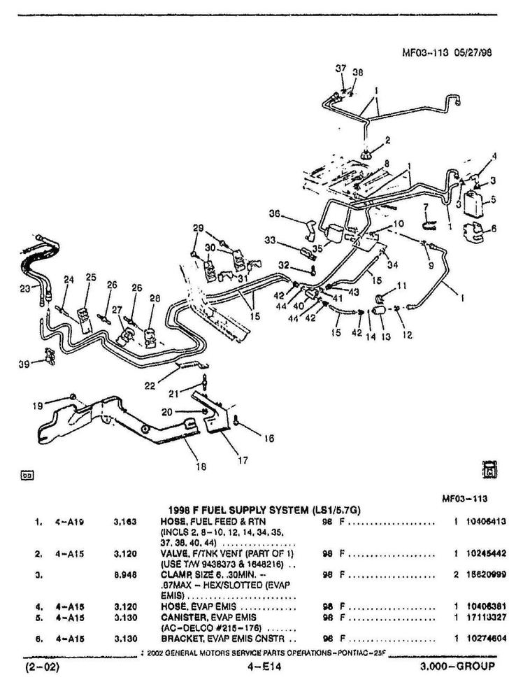

So the aftermarket fuel pressure regulator is mounted just before the feed into the stock fuel rails then and you have the stock evap line connected to the return port on the regulator and the other feed port on the regulator is plugged? Is the stock evap line that is now being used as the return line a straight shot from the regulator to the return port on the fuel bucket top? What did you do with the stock return line that terminates at the "T" located near the factor fuel filter? (#40 in the image below) Did you just remove the "T" fitting and return line while also completely bypassing the stock evap system?
