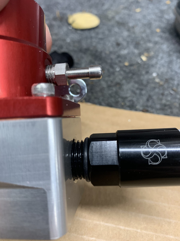

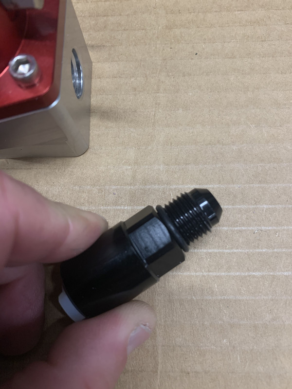

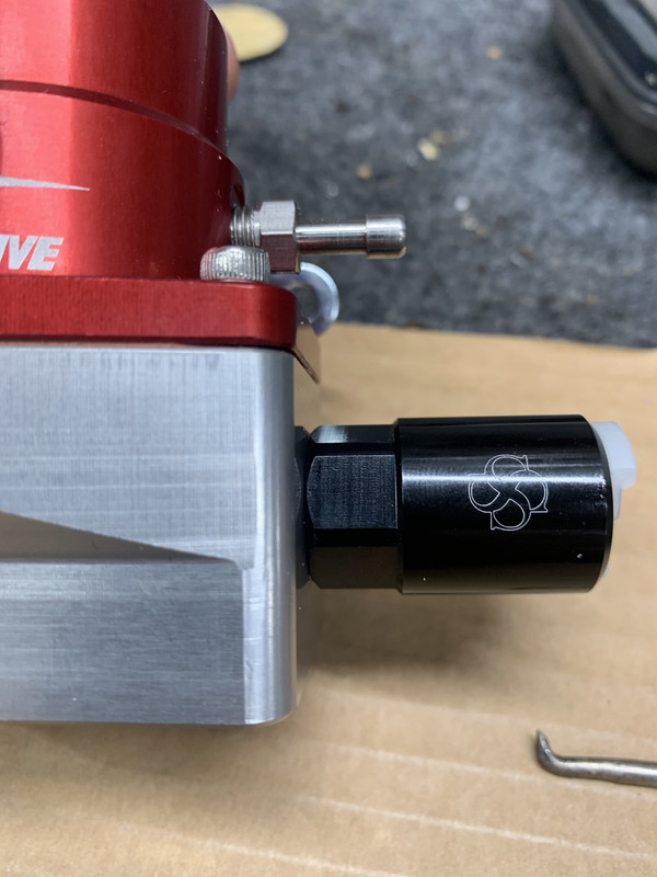

Ok. 6an fits right into a 6orb and the oring fits perfect. All I have to do is machine the tip of it off and I’ll be hood to go. Only one fitting. Less potential leaks.
orb on left

Looks like you figured it out, but you probably could have gotten a 6an orb plug and drilled and tapped it for the 4an threads you needed, as well.
Old Apr 30, 2020 | 07:31 AM
Kfxguy's Avatar
Joined: Apr 2017
Posts: 4,582
Likes: 758
From: Louisiana
that was my next option, I had already bought one.
