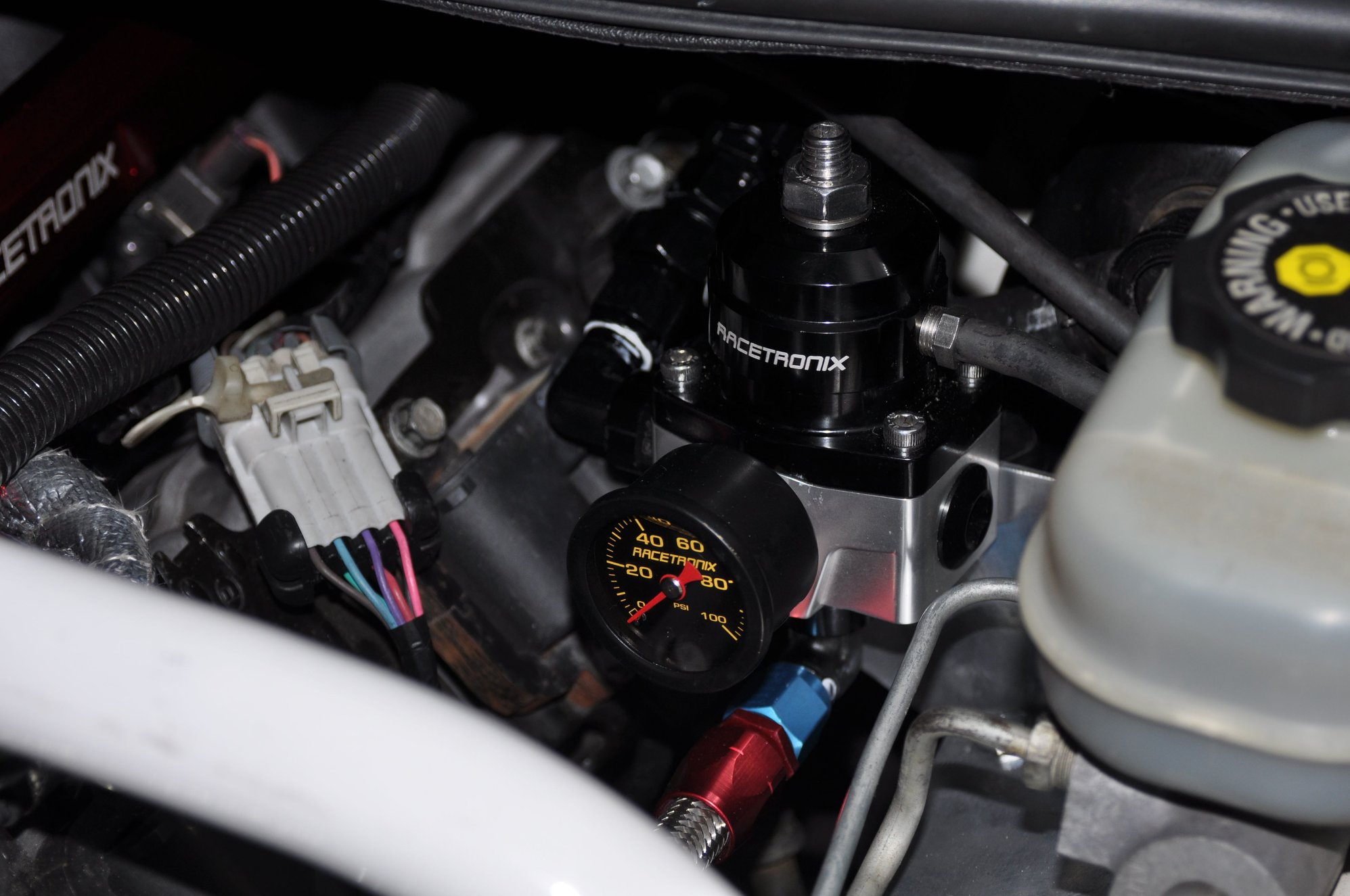

im trying to get ideas how I willrun my fuel lines and mount my regulator in my firebird. Any pictures would be appreciated

I made a bracket out of aluminum. I used Harbor Freight aluminum brazing rods to braze the two pieces together.
The bracket uses existing bolts to mount on the shock tower with easy access to the FPR, entry and exit with -6an fuel return line as well as gauge location, FPR adjustment, and vacuum line from intake manifold to the FPR.
I used the stock fuel line for the return line. I used Aeroquip StartLite -6an fuel line to connect the FPR to the stock -6an fuel line. See pic of stainless covered fuel line. FWIW - the Startlite fuel line is very flexible with a very narrow bend radius for 90 degree bends in the engine bay.
