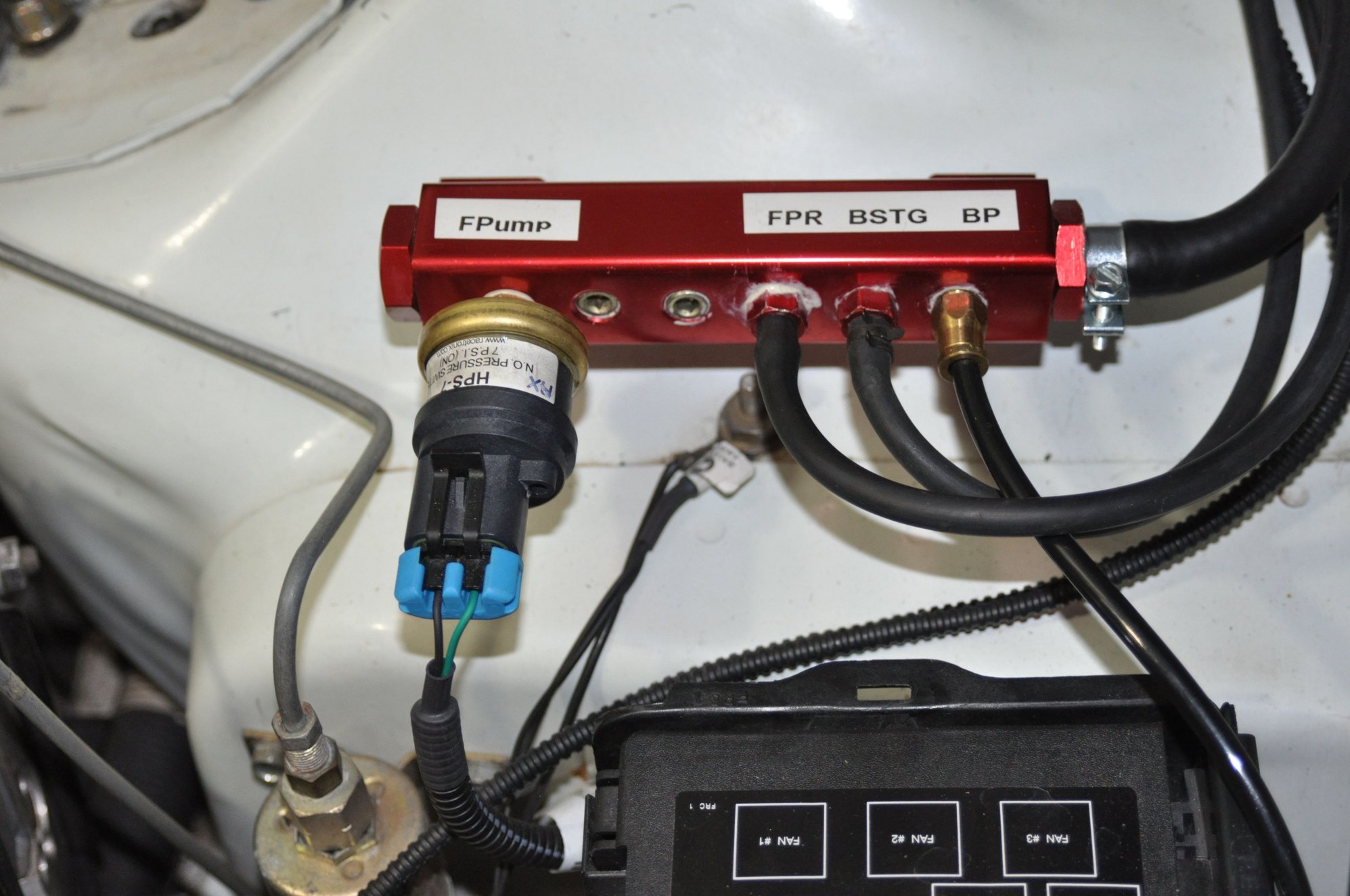

How large is the vacuum hose that is the primary source for the vacuum block? I use the brake booster hose as the vacuum source and T off of it with a 3/8 hose to the vacuum block. I'm using four vacuum ports - Hobbs switch, FPR, Boost Gauge, and ATI Bypass Race valve.

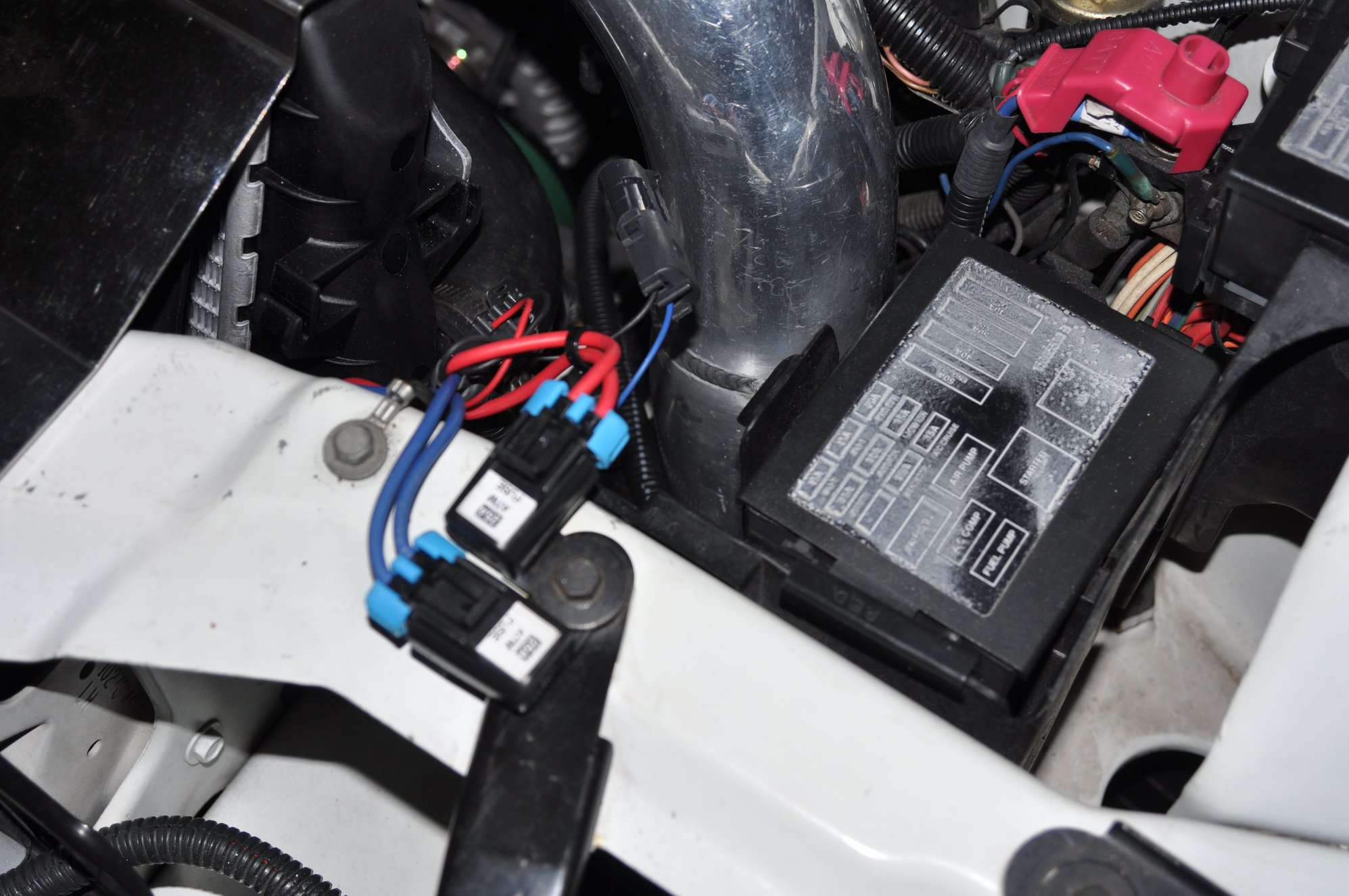

If the wire harness that you built for the second pump isn't pretty much configured the same way with relays and wire size as the Racetronix hot wire kit, then IMO the second harness is suspect? Are you sure that it is coming on at the set boost level? How did you test it?
IMO, the Racetronix dual wire harness for dual pumps is a good harness for dual pumps, because in a matter of you seconds you can test each pump simply by switching the harness plug ends. Each harness end has it own fused plug in connector to complete the circuit. In pic red is for the primary pump, the blue harness plug end runs from the second pump to the Hobbs switch. The second pump fires at 4 psi. See pic.
How are you measuring your boost? Are you sure it is 15 psi?
How are you measuring your fuel pressure at 15 psi of boost?
