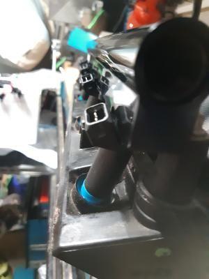

I tried googling this and searching here but i cannot find anyone with the same issue, which i find hard to believe. I have an LS2 intake. I have Deka 80lb injectors EV1 connector LS1 length. The Holley fuel rail leaves no room for the harness pigtail to plug into. I have the Holley spacers to run LS1 injectors in the LS2 manifold. The fuel rail height is just fine, injectors fit nicely into the intake and the rail, i just can plug in my harness.
One of my Facebook forums said to run an injector spacer on the top. I see no reason why it would not work however i do not see why i have to..
Any help is appreciated.

I used a thin washer under the bracket to raise the rail a hair to get the harness on. I do not think i will have any oring issues.
