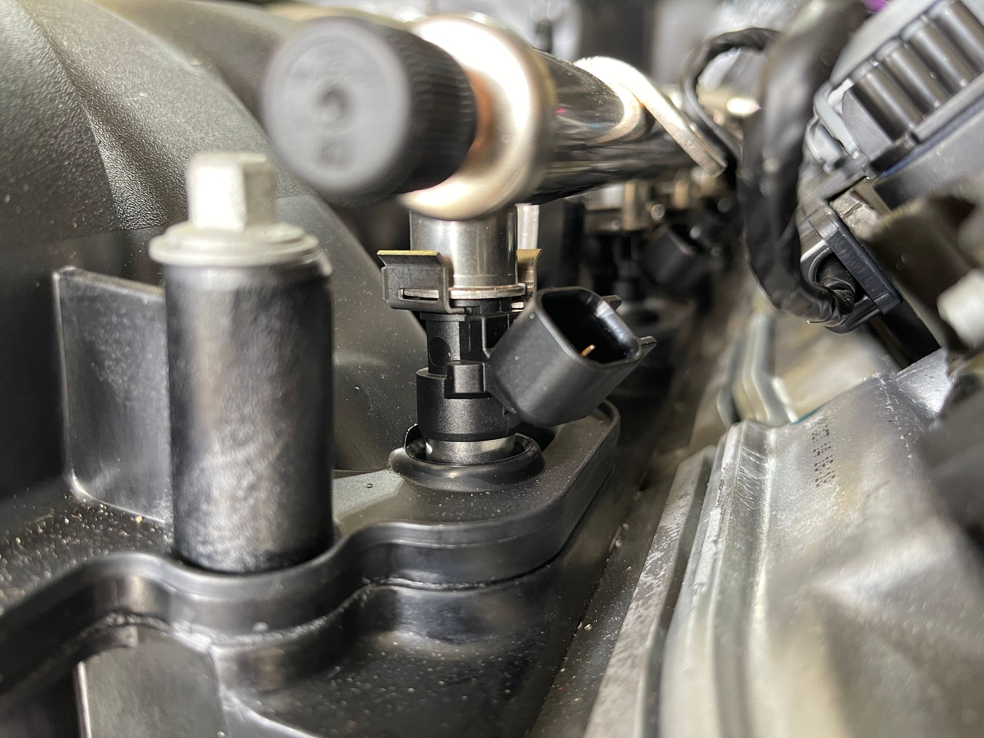

I'm being asked to identify the injector specification on the LS427/570 as EV1 or EV6 so that I can match it up with the right controller. I do not know what they are. I called up the distributor I purchased from. They couldn't identify them and forwarded me to Chevrolet Performance directly. I called them up and they flat out told me they weren't going to tell me because they have a policy not releasing that information. They said they would forward my question directly to engineering, but that I "shouldn't hold my breath." Was kinda taken back by that.
Anyway, can anyone tell me if the injectors on an LS427/570 are EV1 or EV6?

Do you currently have the engine?
I do. Let me get you a picture.

Thoughts?

Those are EV6

To my surprise, and if you have an interest in the response, I just got an email from someone over at GM. Here's what they said...
12576341 - INJECTOR ASM,SEQ M/PORT (injector flow for injector part number 12576341 is 38 lbs per hour and injector part number flow is 51.72 psi per hour)
