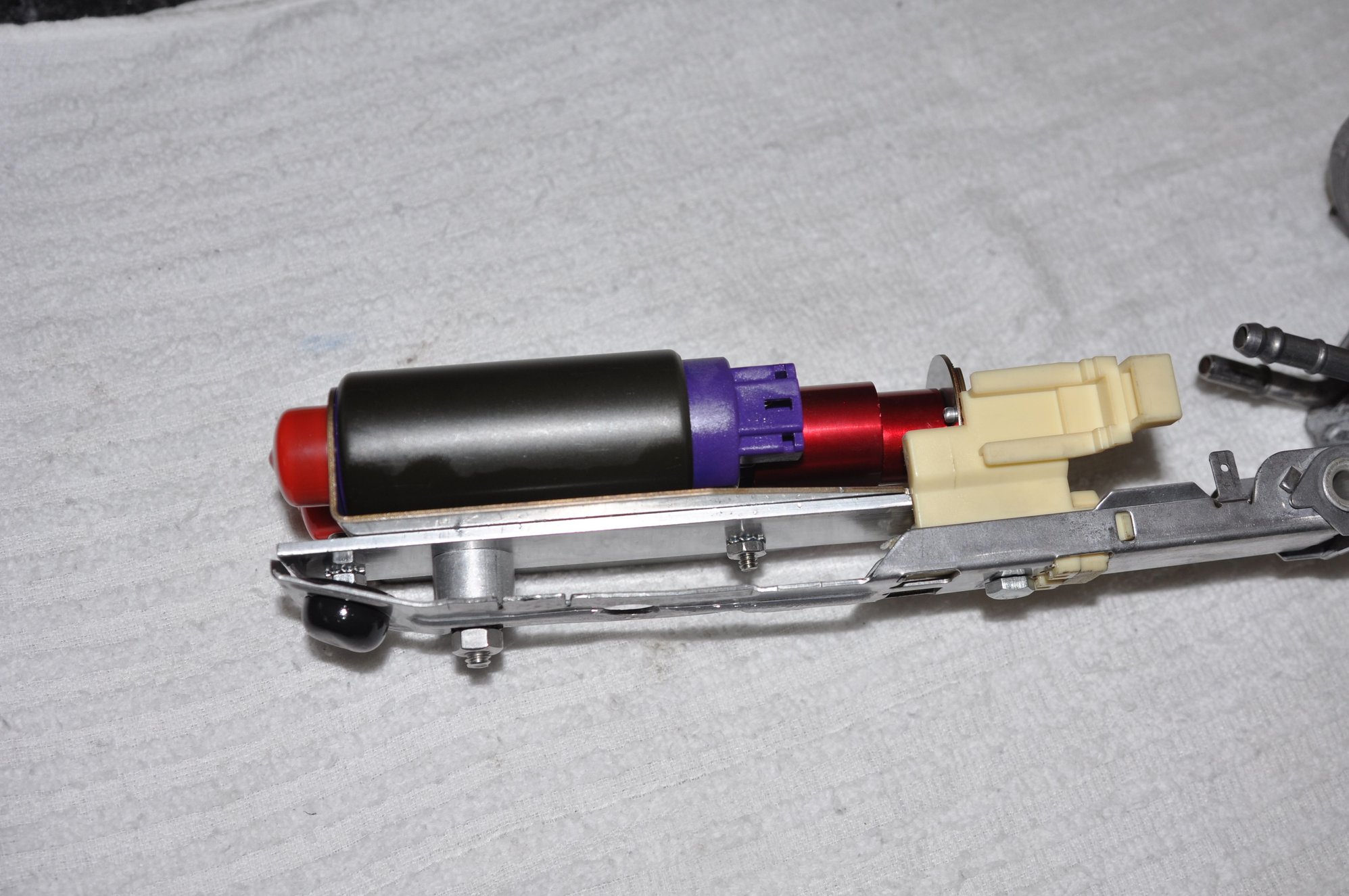

I had to modify the metal hanger in order to mount the dual pumps for a 98. With the Racetronix 99-2002 kit it doesn't appear you have to make any modification to the kit. Am pretty sure you will need to upgrade the fuel feed line if you plan to use e85 and support up to 1000. Check with tech at Racetronix.

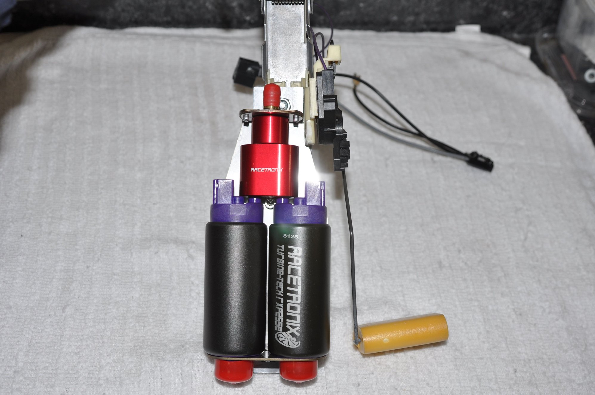

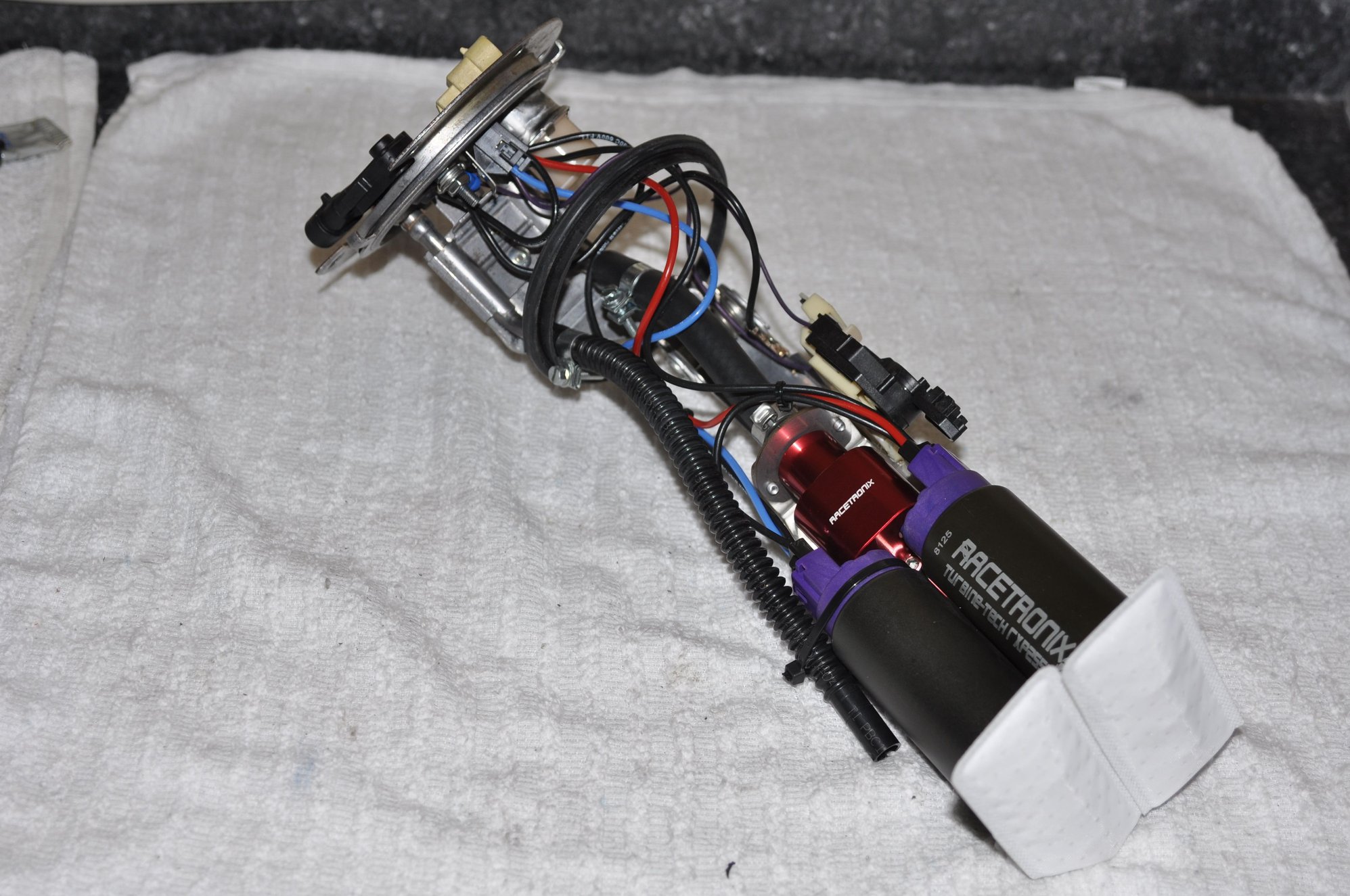

Pics below show the modification necessary to mount dual pumps on the metal 98 hanger. Primary reason for the modification was to allow room for the fuel filters that mount on the bottom of the pumps and also be able to mount the fuel filters and bottom of pumps aft of the metal baffle rear side of the metal 98 fuel tank.
